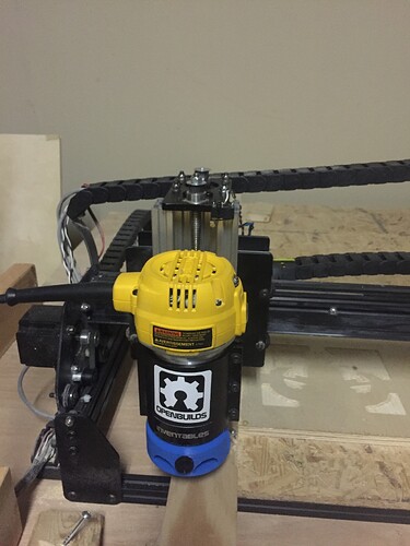

I just got done rebuilding my Z axis with Openbuilds C-rail. It took a little bit of fiddling around with to get everything to fit but its done.
The one nice thing is the extrusion came pre-tapped and the Inventables z nut fit the holes for the carriage. I used the previous z nut holes on the dewalt mount and had to drill and tap 2 more holes to get everything to fit. There was filing here an there enlarge a hole here and there but over all a zimple build. ![:smile: :smile:](https://discuss.inventables.com/images/emoji/apple/smile.png?v=9)
I don’t think it is as much of an improvement as I would have liked for the work (it still has a little play and I am starting to think it is side to side play in the actual bearings) but over all I like having rail slots on the side. I plan on making a dust boot to fit on the new rails.

I could not get all of the play out of my z axis. I tried everything. So I tried rebuilding with a different type of extrusions and solid v-wheels. Tightened things up a little but not a whole lot like I was hoping.
So to answer the question it is just different. (At least for me)

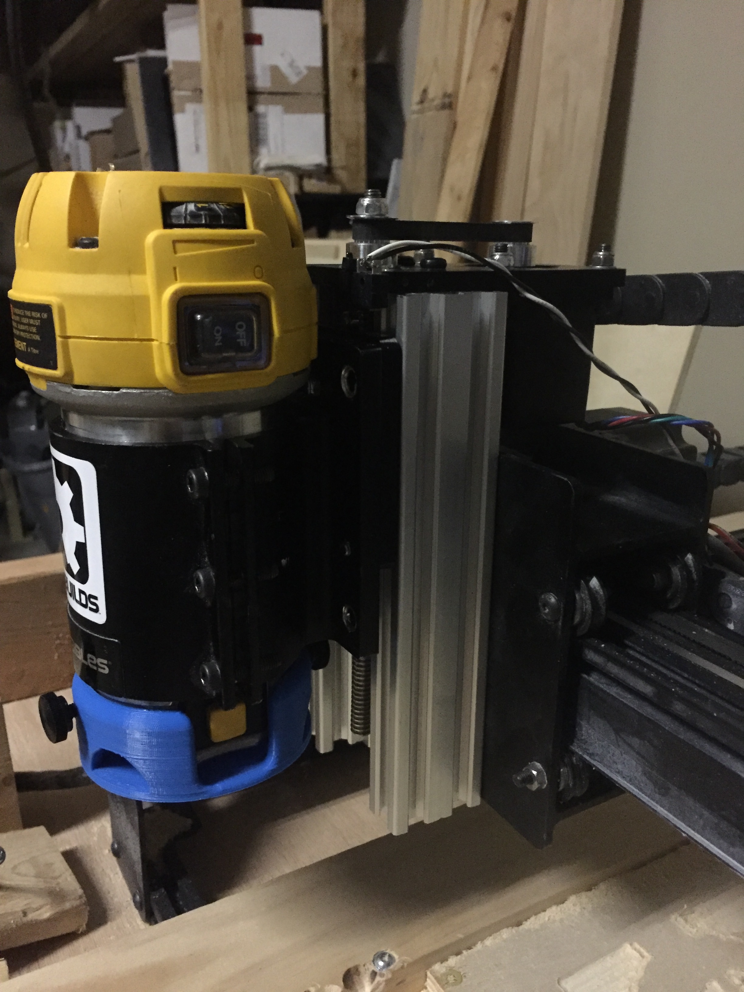

oh nice so the v wheels that you used are they adjustable or do they just ride in a solid track with no adjustment?
They adjust with an eccentric spacer. They are smaller and ride on the inside of the extrusion/
oh ok hmm do you think you could share some of your individual parts that you used?
I bought
C-Beam 40x80 Linear Rail Aluminum Extrusion Profile (250mm I cut to size using a circular saw)
I had to supply 4 Screws, 2 nyloc bolts and 2 washers (to get the z nut to align properly).

Any reason why you didn’t convert to using the stepper motor on top of the gantry as Openbuils shows in their configurations, versus still using the belt?

I just used the stock nut. It took a few washers to get it right though. The only reason I didn’t buy a drop in replacement for the nut was two folds. I only had maybe 200 hours on the original and they were out of stock at the time.
The reason I kept the z motor the same was just a preference thing I liked how it looked and I didn’t want the motor being that high (after you add the coupler it would add and aditional 4-5 in sticking out the top) it did however take a bit of work to get the alignment perpendicular.
The difference is a big. After the air diverted the amount of dust build up on the rails was reduced by 95% (made up percentage but a huge reduction) i hardly have to wipe the rails now and I don’t have to during a job anymore.
