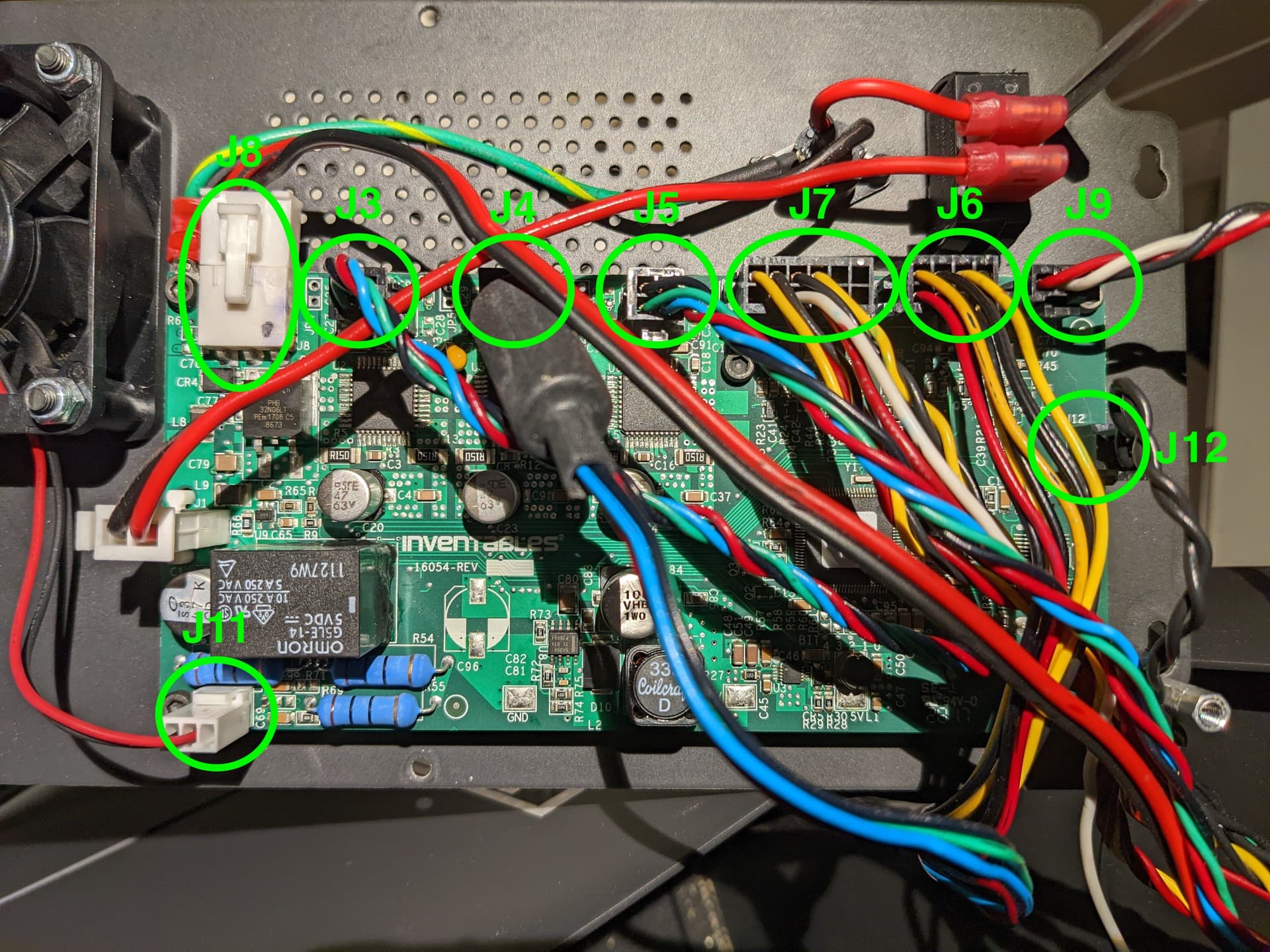

OK. So I’ve had a chance to go through the schematic and pick out the board connections. Each of the molex plugs is labelled J followed by a number, i.e. J1, J2 etc.
The wiring is grouped together by function and area. Spindle / gantry / base / etc.
I’ve overmarked a photo of my board with the plug designations which you can cross reference with the attached pdf.
Hopefully these may be of use to someone else as well.
PINOUTS.pdf (32.6 KB)
The following will also help to decipher the individual molex pin locations. The image shows the pins sockets looking at the board from the same view as above.
I edited the above post as I noticed that I had omitted the details for J12 which connects to the smart clamp. The schematics also show this signal available on J7-5. THis is not a mistake it appears to be connected to both sockets.
