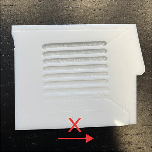

I’m having an issue where both X and Y axis of the Carvey drift up to +1mm when plunging into material.
I guess the force from the bit makes part of the construction flex… There’s definitely some give in the spindle mount itself, as well as in the belts/stepper motors, but I’m not sure if you can really improve that?
The deeper it plunges, the more it drifts, as can be seen in the two images for both X and Y axis - this gets even worse when carving tougher materials like hard wood and aluminium.
Any idea how to improve this?
Has anyone else experienced this problem?
Any help is greatly appreciated!

In general, slotting is always the hardest on the machine. How long is your endmill?
In general, I think we should see better results than that on the Carvey. I definitely try to keep my depth of cut shallower, but in that material I wouldn’t expect that much deviation. Really looks like mechanical slop somewhere.

Is the issue only on the plunge and retract? It’s hard to tell from the pics if the lines are parallel to the axis of motion.
Can you try a simple square, maybe a bit smaller than your other tests? If you can get a video, that’d be helpful.

The drifting seems to only occur when plunging and retracting - this then offsets the rest of the line.
I have carved two squares (35x35mm) with 0.8mm and 2mm stepdown - with plunge and retraction taking place in the bottom right corner of the squares.

I have also noticed that when tugging (even gently) on the bed or router, I can see/feel the wheel of the stepper motors turn slightly, so that seems to be where the give is.
Is this normal, or could something be wrong with either steppers, driver board, or powersupply, etc.?

Right, so when I tug at the bed or the router while looking at the shaft of the stepper motor, I can see that the shaft itself is rotating slightly when it should be held in place firmly - if I add a bit more force it starts skipping, and the bed or router slides.
The stepper motors seem pretty weak, but I’m not sure if that’s just how it’s built?
I did actually tighten both belts, but it didn’t seem to make a difference, so I think the problem is with the steppers themselves.
