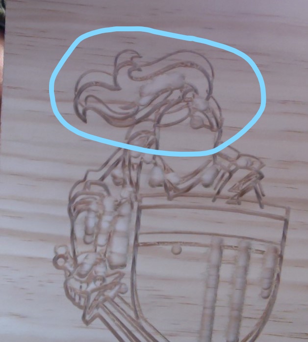

My X-Carve was working absolutely perfect for 4 years until recently. It would be in the middle of a carve and something would cause it to skip on the Y axis. This would cause the carving to be off. It would only happen on the Y axis so I replaced the stepper motors as suggested by another user. I still have the issue. I checked my V wheels and they are not tight at all. Just for testing purposed I swapped the X and Y axis now the “skipping” occurs on the X axis. Could this be the controller? Could it be a power issue? Any thoughts on this are GREATLY appreciated!

If its the former I bet the Y-driver is overheating, causing a brief shut-down until it cools again. (milliseconds).
Since you have the older gshield and its your Y-axis that is acting up I suspect the main issue is lack of power AND/OR over-heating.
A single stepper driver run two Y-steppers => they get half the power each compared to X/Z => more likely to loose steps
Over time fine dust etc may build inside the controller => poorer cooling conditions. Can result in overheating after some time, like 4years.
You can clean the driver board as an immideate measure, along with measuring the reference voltage for X/Y/Z axis. This voltage govern current limit for each driver, and may not be ideal set.
Overheating is not a problem in terms of the circuit itself, its a preventive measure. The carve is toast, but the driver will most likely be fine. So tuning this may be good thing
