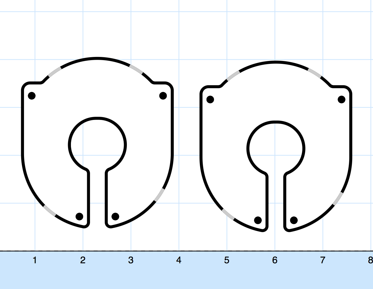

Changing .STL file to a format compatible with easel?
Is it possible to convert an .STL file to a compatible format for easel?
I bought the suckit dust boot a week ago…and I managed to crack the router plate. They have an STL file available on GrabCad but I can’t get the file into easel as it’s a full 3d file.
Please let me know if there’s a relatively easy way that anyone has converted one. Thank you.
I opened the STLs in VCarve and ImageTraced them and exported as SVGs. I won’t claim that they are dead on, but should work.
SUCKIT PLATES.zip (19.6 KB)
I made this version in Easel a while ago for the version with the slot in it.
I made it from polycarbonate. YMMV.
