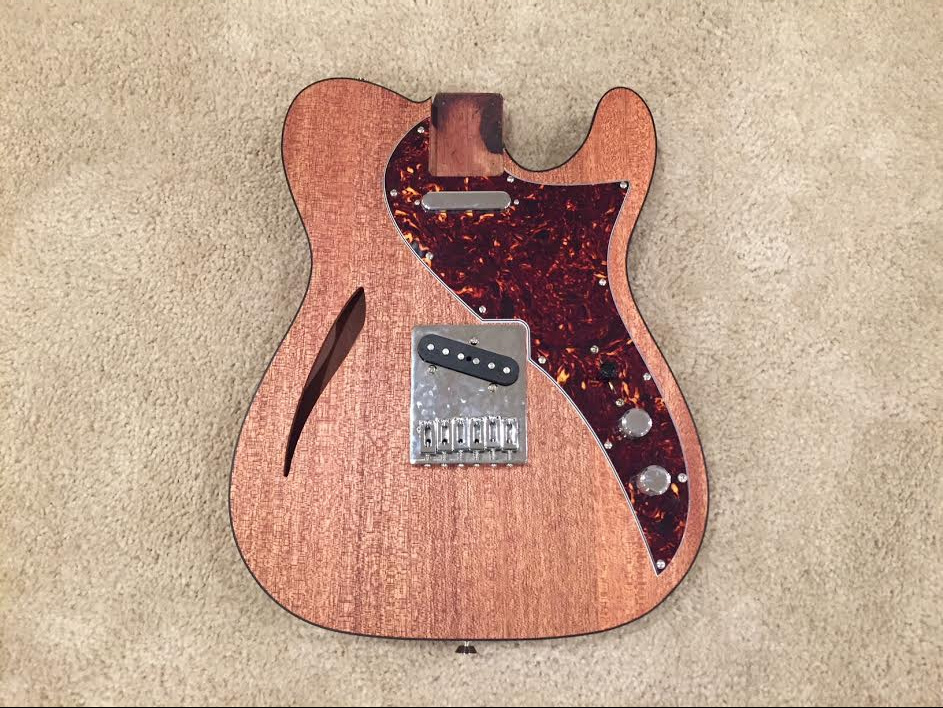

This required two bits - a 1/16" 2 flute and a 90 deg v bit. All of the holes were “drilled” with the 1/16th and the neck pocket outline was as well. The outline and screw holes were reamed using the 90 deg v bit so that the profile of the screw heads would seat nicely.
Trouble! I have a grounding issue with my wiring and I’m not sure where. I wired up everything using a schematic from Seymour Duncan, but it has a very loud ground hum when it’s plugged into an amp, and even louder when you touch anything metal. I did buy the pots/pickups second hand (supposedly pulled from a new tele), so I’m not sure if it’s my wiring or a bad component. Anyone have any ideas how to troubleshoot this effectively?
Check to see if you have the jack wires reversed. Did you put a ground wire under the bridge and soldered to a pot back? Check the wiring diagram from Guitarelectronics.com. I"m not sure why it is described as 3 singles because it is in the 2 pickup section :-).

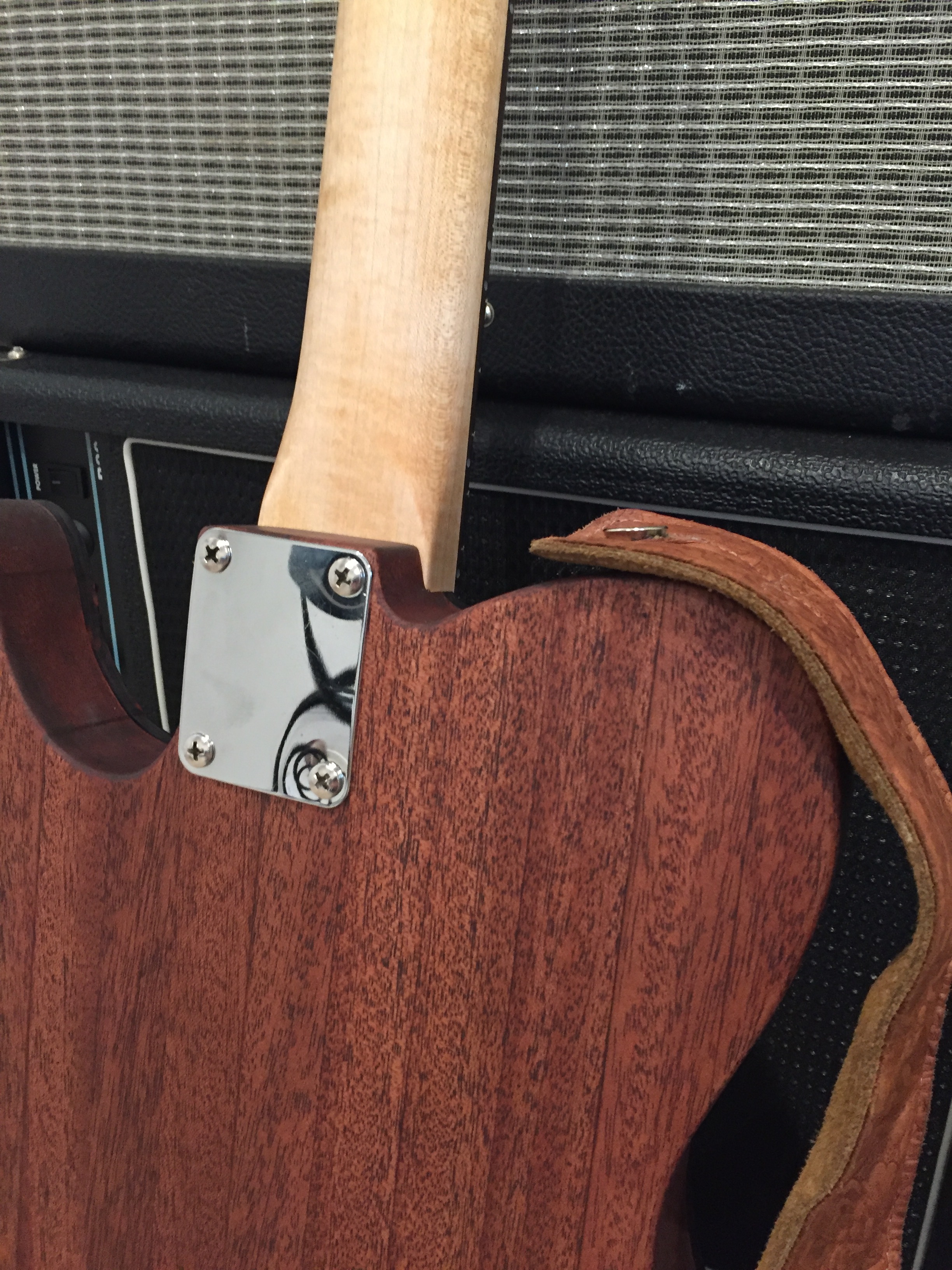

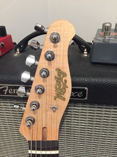

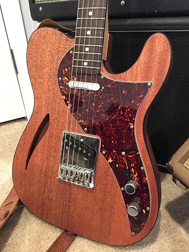

I finished the build a few months ago and forgot to post pictures! I had a lot of buzzing at first and ended up taking another 1/16th from the neck pocket. The action is still a little bit high, but it does play pretty well. I also ended up purchasing prewired pots/switch. I had mine wired the same way, so something was faulty. The only thing I’m going to do now is replace the saddles with old school brass barrel types that aren’t as long. The modern saddles would be good on a 25” scale, but at 25.5” I’ve got them almost tight to the back of the bridge to intonate. All around I’m pretty happy with it as a first build. I learned a lot that’s is going to make #2 a whole lot easier to build and the quality even better!
Looks good. Vintage tele bridges are shorter than the modern ones, so you may have to drill new holes or buy a bridge and replace them on the current one…if they are long enough.
Lighter strings require more intonation. If you went with a little heavier set of strings then you can move those saddles forward. The problem with changing saddles is that the slots on a barrel saddle are not centered, so it will shift the strings to one side. That bridge wont accommodate barrel saddles. You will need to get a new bridge to account for the off center slots on barrel saddles. The string holes in the body may not line up either. To lower action, put a small shim in the back side of the neck pocket. I typically will use a piece of .010 plastic binding. I have recently switched to putting a 1.5 degree neck angle on all my instruments which gives me a bit more adjustment to fine tune them. You might be able to use the Mustang saddles with that bridge but I’m not sure.
I bought a whole new bridge and the schematic shows the body holes lining up. We’ll see. I put 10’s on, so I can try 11’s. 12 is pretty thick for my taste.
