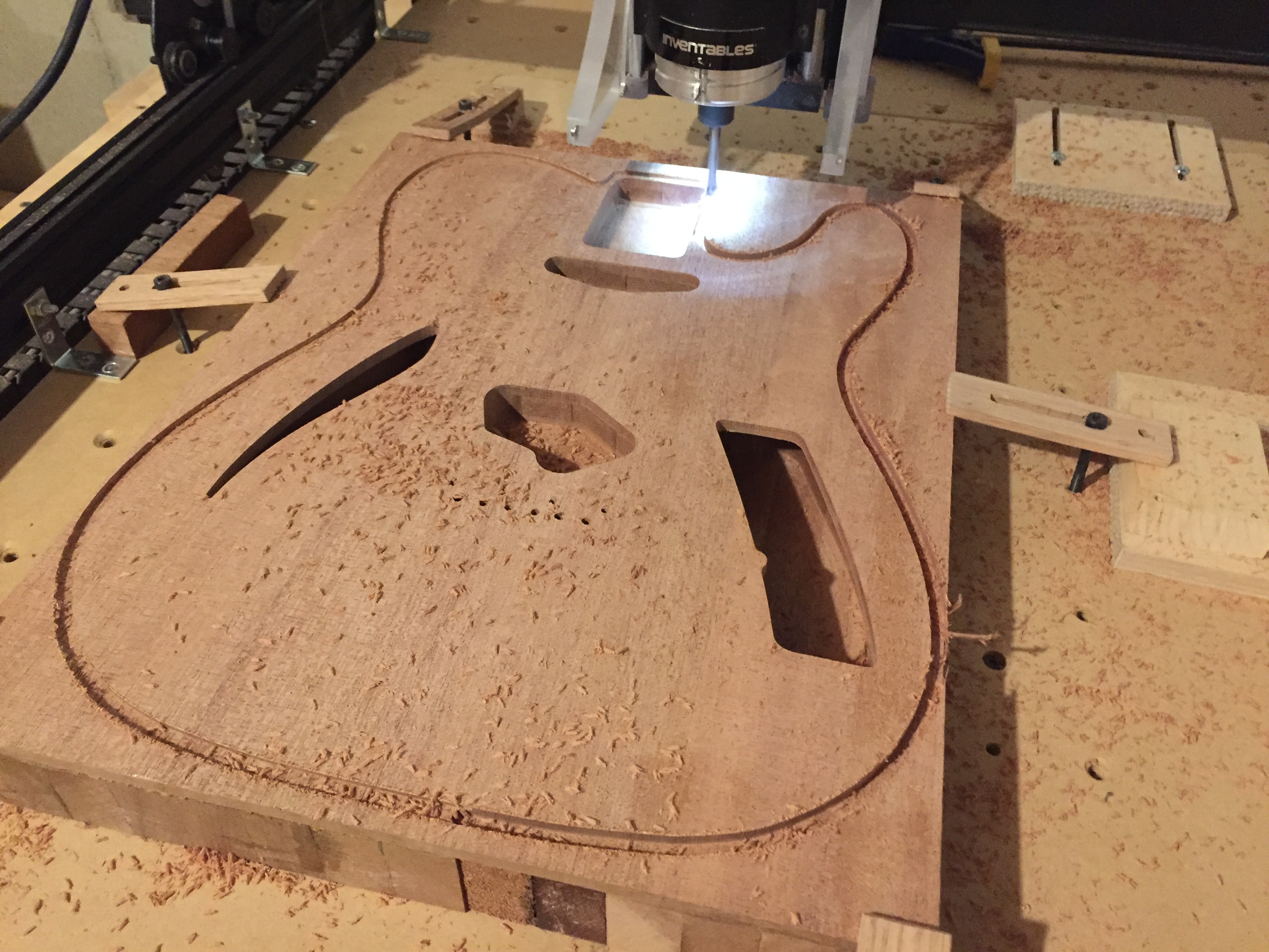

The boards I used for the body: 5x23" 5/4, ripped to 1.5 inches and edge glued.
The glue up was 13.25" wide, which is too big for my planer! I used some side clamps to plane both sides on the xcarve just like leveling the wasteboard.
Pockets cut!
Next I ripped two of the boards into 0.3" pieces and planed them down to 1/4". Lots of waste here as I don’t have a bandsaw, so I had a 1/8" kerf :frowning: I also don’t have a jointer so I used my Dewalt 611 and a flush cut bit to joint the boards. This actually worked really well. The glue joint is great. I edge glued these pieces using tape just like I would for an acoustic top.
After gluing the top, I cut the pickup pockets, “f hole”, and drilled my bridge pilot holes. I ran into an issue where my drawing was off 1/16" from my bridge (Fender MIM standard). Gah… so I had to fill the holes with end grain saw dust and some titebond. At least it’s under the bridge! The top has not been sanded yet so that’s why you can see glue.
I’m going to try cutting the binding channel with the x-carve using an outside path. My binding will arrive tomorrow, so I’ll run a test piece and see how it fits before cutting the body profile. To be continued…

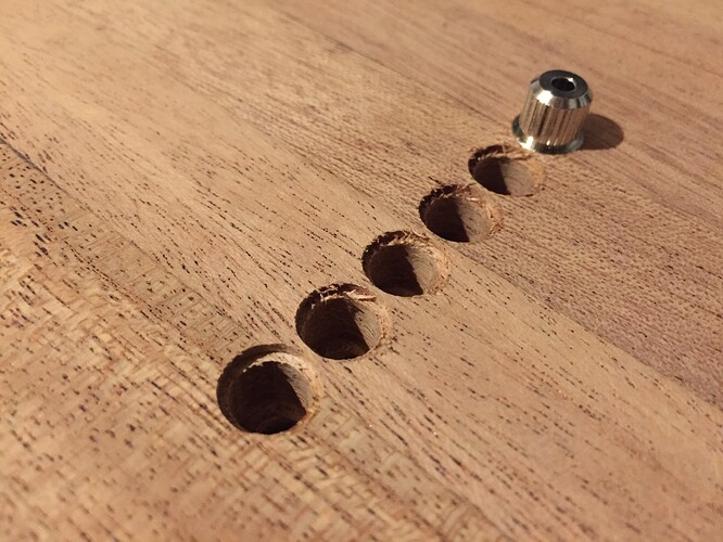

Progress! String ferrule pockets have been routed, the binding channel and profile are all done, and I put a 1/8” round over on the back.
I did have something wrong with my toolpath. My neck pocket had 1/16th material remaining on the top and right sides. It’s not a big deal though. Chiseled it away and only the whole Internet and me will know :smiley:
Impressive! Keep going…
It turns out the material that was left around the neck pocket was not a measurement issue. It was simply the order in which I cut the neck pocket. Had I cut the pocket after the binding channel it would have been fine.

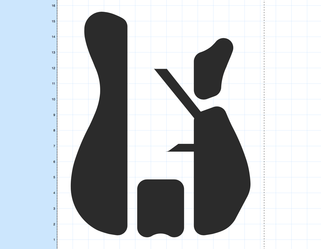

Aaand as promised here are the source files for the body:
Easel Project:
SVG Files:
body_cut_1_chambers body_cut_2_pockets body_cut_3_f_hole body_cut_5_string_ferrules body_cut_4_bridge_pilot_holes body_cut_6_outline pickguard fretboard_cut_2_profile neck_cut_1_truss_pocket_neck_pilot_holes fretboard_cut_1_fret_slots_and_dots neck_cut_2_profile_tuner_holes

Hello, great build! I was looking at your files, and was wondering why some of the carves were oriented sideways or upside down, while the rest were all in an ‘upright’ position?
