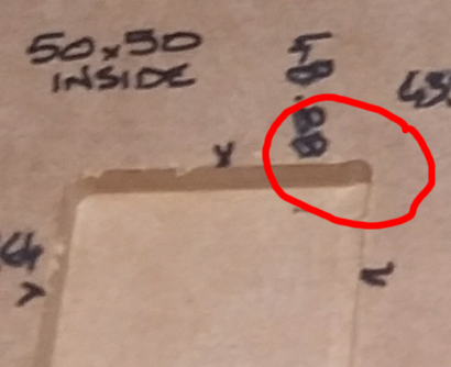

Test out put using Easel. The 150mm line is done with and attached pencil. Now I’m really confused. There is no play in the wheels or frame.
Just to be clear, there is NO machine that do not have some sort of play
The high dollar ones there is barely any, but always some. Thats why there is compensation settings present in such systems.
The reason I suggested circles with different diameter was to see if the deviation was the same throughout or increased with larger circles. If they were consistently cut say 1mm short on all, then you have a 0.5mm system play going on.
That would be a combination of rigidity (lack of), tool deflection and back lash.
This image suggest that you do have some play, circled in red is the entry/retraction point of your router, when it plunge/lift there is “no” sideway forces given, but when the router start to cut X/Y the bit will want to drag behind.

BTW - if your end mill is actually turning dark like the photo suggest => it is heating up => going to slow / rpm to high.
