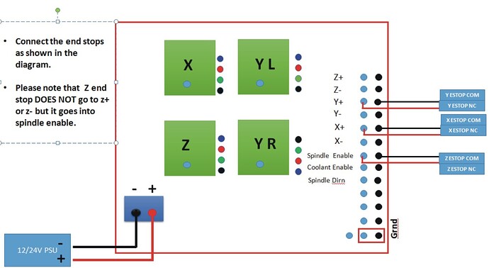

I haven’t used one of these, but the picture of the board does not match the instruction diagram.
The instructions indicate that the jumper is only available starting with version 3.02 of the board, but the picture is not of a 3.02 board.
This would lead me to believe that if it is a board prior to 3.02 then you don’t have the option of running Normally Closed.
@PhilJohnson
This appears to be what you need to run the switches as Normally Open for a pre 3.02 board. Repeat for each axis.
There may be a problem with the Pin 11/12 swap that occurred between grbl 0.8? and 0.9?
This board is made by Protoneer
The 3.0 board is setup for GRBL v0.8 and has no noise suppressing capacitors for the end switches. The 3.51 board is setup for GRBL v0.9 and comes with the noise suppressing capacitors installed although you have to solder all the other components. There is a pinout change between v0.8 and v0.9 so you need to know which version of GRBL you are running.

The connection is correct if you are running grbl v0.9 on an v0.8 board. See this page for the differences.
It depends on the version of the board that you have. 3.0 is set up for grbl version 0.8
By putting the Z homing switch on spindle enable it is the same thing as reversing D11/D12.
