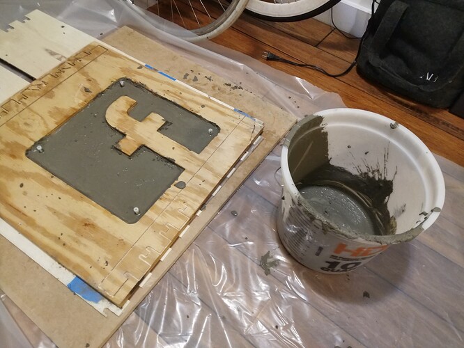

For the next go, I decided to just make the concrete form out of plywood entirely. I used some scrap 3/4" ply, and a 1/8" carving bit with a slight angle— the idea being that tapered walls would make the plywood form easier to remove.
After cutting the form, we mixed some of this Shapecrete concrete mix. In retrospect, probably any decent concrete mix would have worked for this:
Again, my first attempt with this failed. The problem was in removing the plywood form after the concrete cured. Instead of pulling away the form, I tried to push the concrete tile out of it. This ended it with it cracking around its weak points.
For the second attempt, I just used a circular saw to cut the form down to the point where it was thin enough to just pull away or, in the case of the “f”, pound out:
For anybody trying to do a project like this, I would recommend having your initial plywood form just be a silhouette with thin walls. That way you won’t have to cut it down or carve it out like I did.

I tried canola oil. Unfortunately my local Home Depot didn’t have any release agent, but I’ll try to get some for next time.
I have previously done similar types of things with wood and rubber forms. Just make sure the plywood walls do not over hang at all and use a release agent like the others said. I just use Carnauba car wax and stuff always pops put easily. Only problem is that some wax will come off with concrete. I had various bricks made before but then just used a grinder to knock off the shiny parts. It worked out because it actually made them all look different rather then copies.
Try a hobby store or a place that sells plastics (like Tap plastics).
The concrete guy I know uses motor oil on his forms.
I heard about that as an option. Apparently diesel works too? Might try that next time instead of canola oil.
