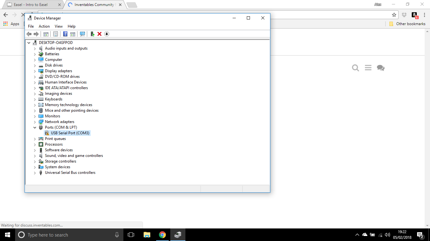

I keep getting an error saying on the com port
i’ve installed the FTDI drivers but nothing.
Getting really fed up with this thing. I might return it and go back to the old set up.
leave it a little bit of time, turn the controller off and on again and the com port is now fine but easel still doesn’t see it.
