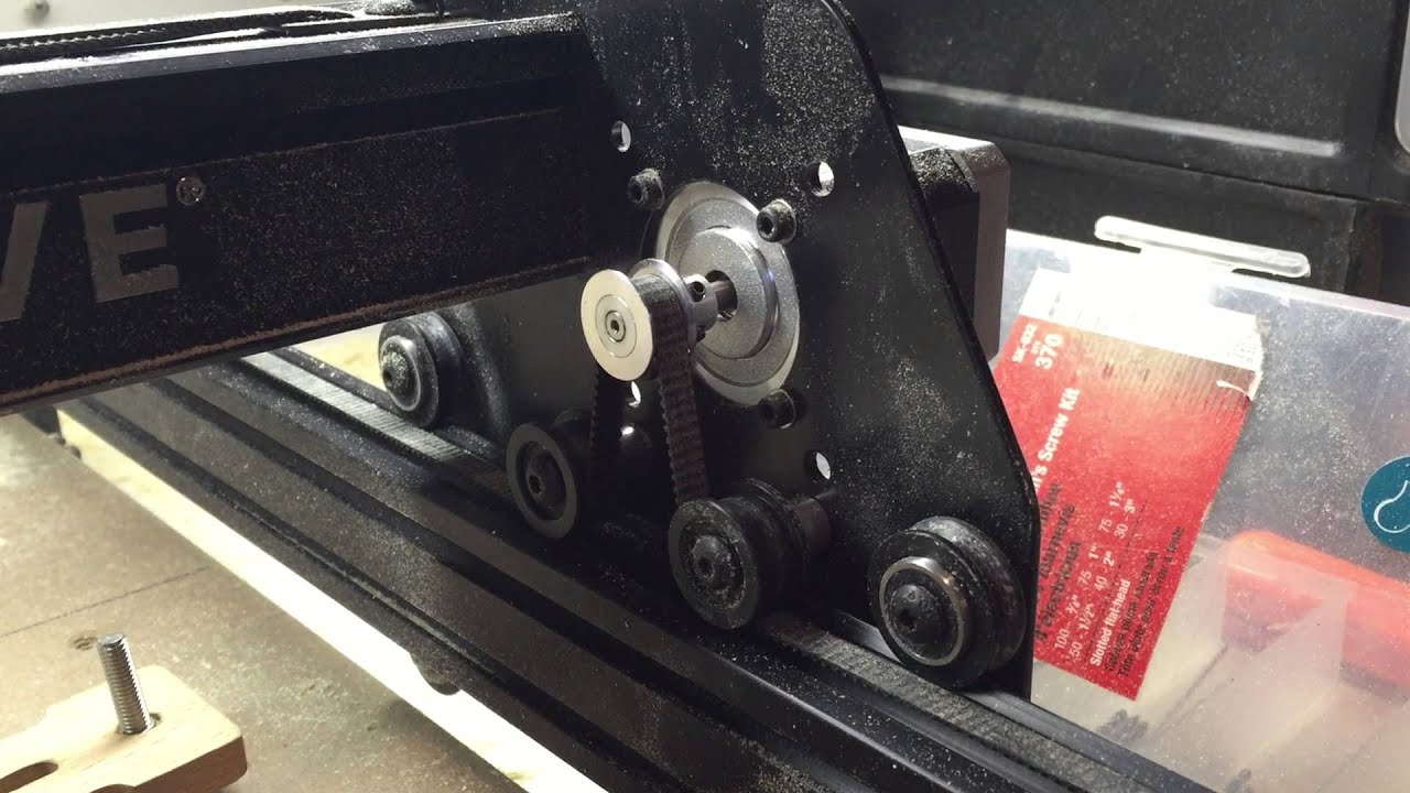

I’ve yet to complete a project without the machine skipping, usually happens when the machine lifts the bit to move to a new section. I’m pretty sure it’s an operator or assembly issue. Yet I haven’t been able to identify the issue. I’m running Easel with safari and my macbook air
So far I have:
  • adjusted the tension on the belt. In both directions, thinking I
    might have had too much, or the belt was slipping. Currently it’s
    tight, “like a guitar string”
  • slowed the feed rate and adjusted the cutting depth
  • confirmed project is secured to the table
Video of tracking issue is here:
Project is here:
Have you adjusted the power to your stepper motors?
Not that I know of. Is that done in Easel?
No, it is done of the G-Shield…check out this post it appears to be your Y-Axis:

I’ve also checked all of the carriage wheels, and they are tight and rolling well.
When I stop the printing and the carver goes home, it lands about 1" to 2" off the Y axis. It’s always the Y axis too.
Please look at the post I referenced above. Are you using an X-Carve with the default hardware (arduino and g-shield)?

If you have the standard hardware, you have a g-shield connected to your arduino which is controlling the machine. There is a lot to digest, but it gets easier.
my invoice indicates I have the shield
X-Carve Arduino/gShield Motion Controller Kit - 30574-02
Joel - there is a hardware component to the machine that makes magic happen. Out of the box the hardware will likely need some adjustments. Read the previous posts and adjust the current on stepper drivers. Report back. Thanks.
Finally got around to making the adjustments. Works like a charm now. Thanks everyone for the insight and help.
