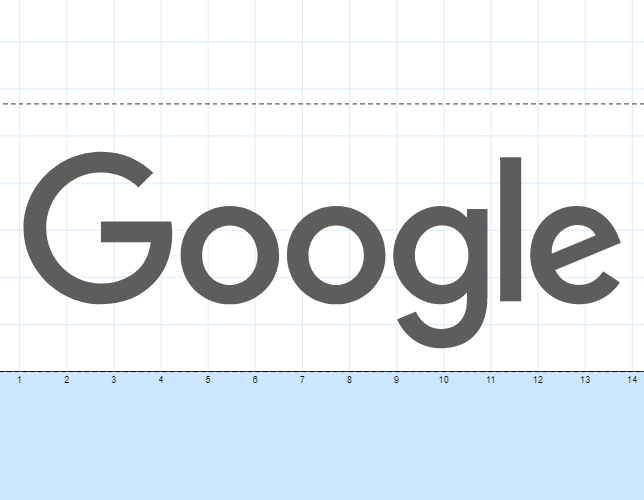

Corners/edges have extra material cut out
Some of the edges on my project have extra deep corners cut out of them, even though this doesn’t exist in the Easel render. In the attached image, the problem is in the top right of the center rectangle. These should just be simple 90 degree angles.
Anyone else have this problem?
This is using a 1/8" downcut bit. Sometimes it’s less pronounced than this image, but it’s happening all over the place.
Any advice to avoid this?
Thanks.
could you share the easel file or the svg file please
those look like dog bone fillets to me it is weird that they are different length but I would like to verify the file first

Google_2015_logo

Try a quick test carve, carving a “l” as in Google like you did in the image above.
Do one deep and another “l” shallow,
For instance one 3/4" deep and the other 1/8" deep. Compare the two entry/exit area of each “l”
Please post a pic :wink:
Thanks Haldor. The pronounced corners are very apparent. It’s always worst in the top-right corner, but the bottom left is problematic too. Here’s what I’ve got.
