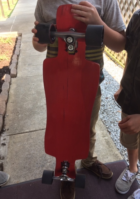

I took the Labor Day weekend to crank my machine back up and start a custom longboard project. I took inspiration from @ILikeToMakeStuff build. This project consisted of:
3D milling the mold
2D milling the drop through template
Building a custom vacuum bag
The mold is 48" long and the tool paths were created using Fusion360
The CNC didn’t help with the vacuum bags but they turned out well nevertheless! This is a cool way to form veneers. I see much potential in these bags.

Update! Longboard is 90% complete. Only one truck cutout remains. All the CNC’ing worked out great. Vacuum bags did an amazing job compressing the maple veneers! I’m super pleased.

@MidnightMaker - Thanks! The board is 7-layers of maple veneers specifically cut for longboards/skateboards. All maple wood. Veneers came from Marwood Veneers. If you buy 10+, 7-layer sets the cost per set is reasonable. They crated and shipped for ~$25, I think.
hi @KikoLobo - The boards were too long for my 1000x1000 machine, so I cut them by hand. I used the CNC for the molds and for the drop-through truck template cutout.
Very nice. When I saw you mention longboard on your vacuum bag thread, I was wondering what part you would use the X-Carve to make, since I was thinking surfboard, not skateboard. I’d love to see pictures of the finished board, and video of you riding it.
Thanks @SauliusMuliolis. I completed two unfinished boards and donated them to my nephew and a young rider needing a longboard. They both were finished by the recipients and turned out great. I don’t ride. I just engineer the fun.
