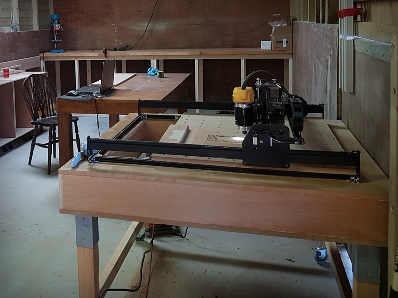

We re-arranged our crossbracing to allow for a similar hole while still providing rigidity. We also planned an opening in our (extremely thick) torsion box table top to allow for vertical clamping. We have a removable bit of wasteboard to cover the hole, but it’s removed in this pic (you can see it laying on the table in the background).
Please excuse our lack of tools and relative tidiness in this pic. We had only been in our new house for a few months when this was taken, so we didn’t have time to fill our workshop with junk and make it all “lived in” yet.

We drilled holes and put threaded inserts into the ‘wall’ of the opening that’s closest to the middle of our machine so we can clamp the piece just like we would on our wasteboard, but using more clamps to be sure it doesn’t fall.
Or you can probably also do what Angus said. In our case, the extrusion is set back just slightly from the hole in our table. We intentionally left a small ledge of table around to fully support our frame.

I was suggesting for @DaveEastham’s idea of a rack and pinion lift for his vertically-mounted workpiece, instead of the removable wrench coming out the top, like in a router table, he could do a crank handle coming out the front of his table, as on a table saw. We don’t have any sort of lift system for the workpiece in ours. We put threaded inserts into one of the faces of the opening in our table, and clamp to it.
But what you’re talking about, I think, is the opening, itself. Something more like what we have done here (this is from up above in the thread): Cutting a hole in my wasteboard except your table would be open in the front? So your table would have more of a U type shape with two ‘arms’ sticking out to support the X-Carve’s rails?.. Would you have cross-bracing between the extended part of the rails?
