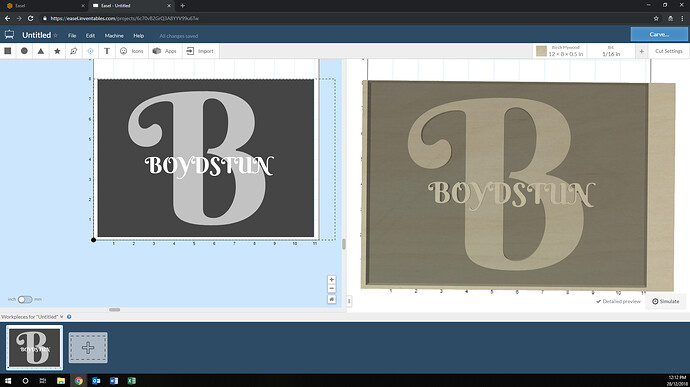

If I want to cut out a big “B”, on top of the big “B” I want to put my last name across the “B”, How do I get the writing to go over the “B”. Everything I have tired the “B” still comes out under my name. I have not found anyway to erase what I don’t want to be seen. Any help on this. Dave
perhaps you could draw out an example so that we can see what you describe.
select the B.
right click
send to back
set the name to zero depth of cut
That did not work
I did that, the letters disappeared except where it goes through the big “B”
That is it, so now how did you do it
you need a square behind the whole design to be cut lower than every thing else. The name is zero depth and the B is anywhere in between zero and the square depth
