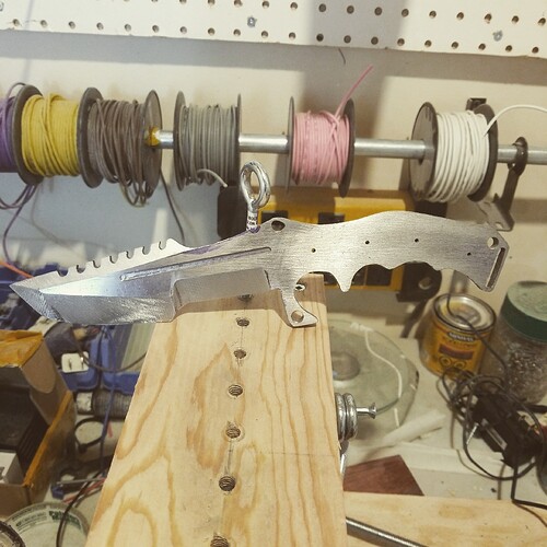

I have cut flat-bar aluminum and I have the dewalt 611. it also helps to have a rag handy. Here is a pic of one of the things I did. its about the size of a 50 cent piece or 40mm x 40mm

The oil did not cause me any grief. however that pic above was done without any lube.
It did create a lot of chips. Some of the chips I had to clean up. I put up some blocks to help shield and keep the chips from flying too far. Then vacuumed them up. Cleanup was simple as I just wiped down the dust boot.
I was able to cut 01 tool steel pretty easily with my stock 16 xcarve.

How long did it take to cut that? I presume you went slow, shallow depth per pass, and so on.
10 minutes per side I believe it was
