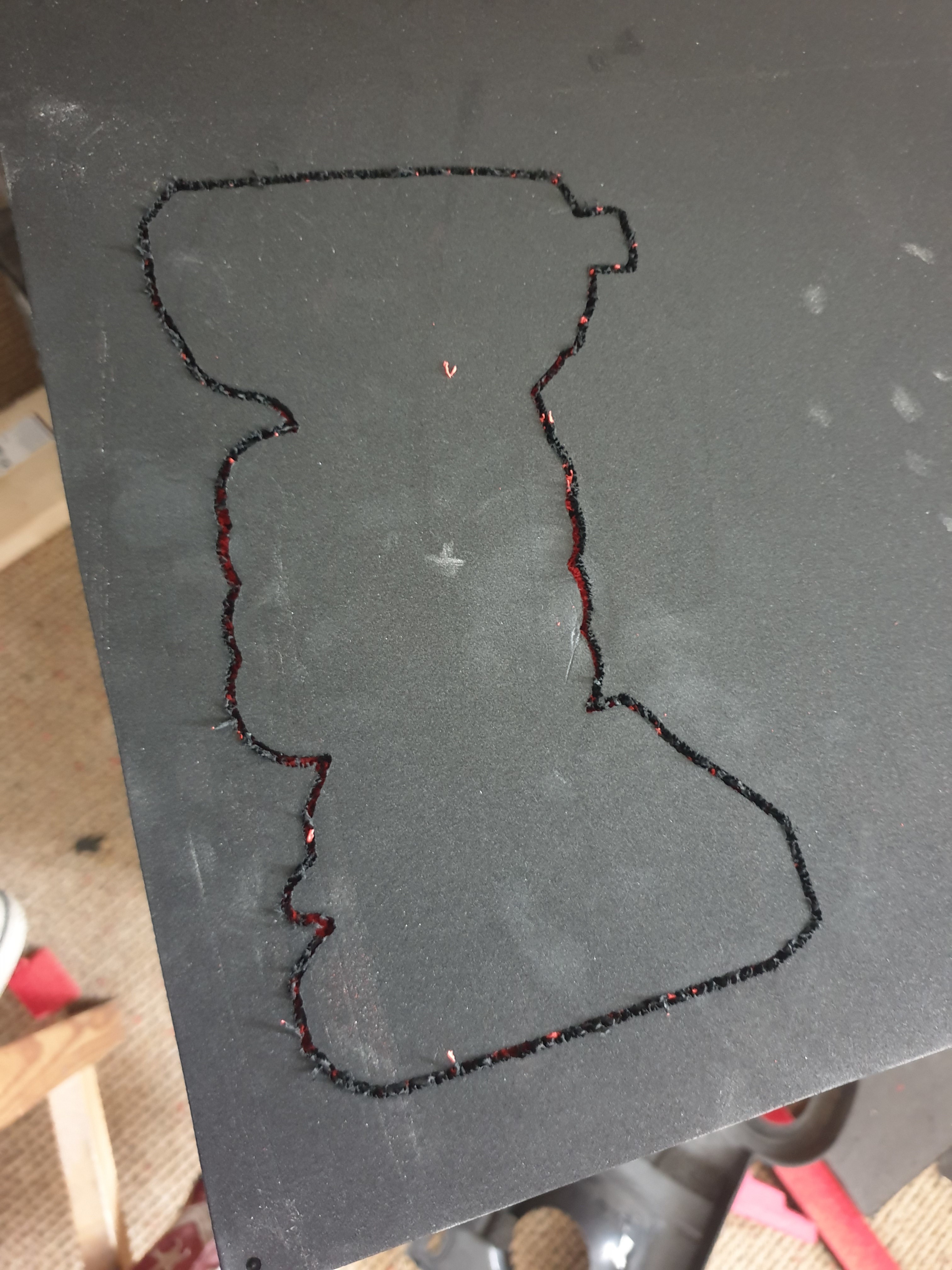

I have a specific foam bit i bought but have tried a few more with varying setting the current bit leaves a great finish when the tool path goes clockwise but when going anticlockwise it roughs the edges fraying them.
Ok did a little test today so you can see what’s happening. When cutting the tools path was anti clockwise and you can see the finish in the second picture the inside edge of the cut is great. Then in the third picture the finish on the outside edge which is the one I need to be good as all the inside material will be removed is terrible in comparison.

Easel does not allow the user to select between climb and conventional milling directions.
Many other software’s allow the user to make this selection. IF you require this setting you might need to pursue other software options.
Thank you. I really like how user friendly Easel is though, got started in 5 mins. So for the moment I’ll stick to it and reverse the cables on the drill, that worked good. Hopefully the option will be added in the future.
