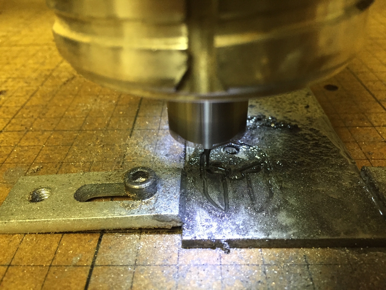

Successfully cutting Grade 5 Titanium.

What kind of feed/speed/bit did you use? What Dewalt speed? How long did it take? I thought titanium was beyond what the X-Carve could do, but looks like I’m (happily) wrong. :smile:
2in/Min Depth is .002 per pass. The Dewalt is set on speed 1. It’s still going strong as I type this. I’m using a small 1mm flat endmill.
Someone over at Carbide forums milled a multitool from titanium using the Nomad 883. The Nomad looks a fair bit stiffer than the XCarve, but the multitool turned out well enough for me to want to try milling titanium of my own.

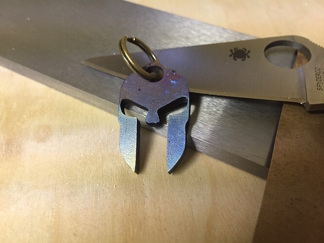

OK, It’s all done. I guess it took just under two hours to complete. I’ll finish it with maybe a flame anodize.
That looks great. Well done.
Now, It looks better.
Side 1
Side 2
My IPhone just doesn’t do it justice, the colors are so bright.
Hope this encourages everyone to push the XCarve.
