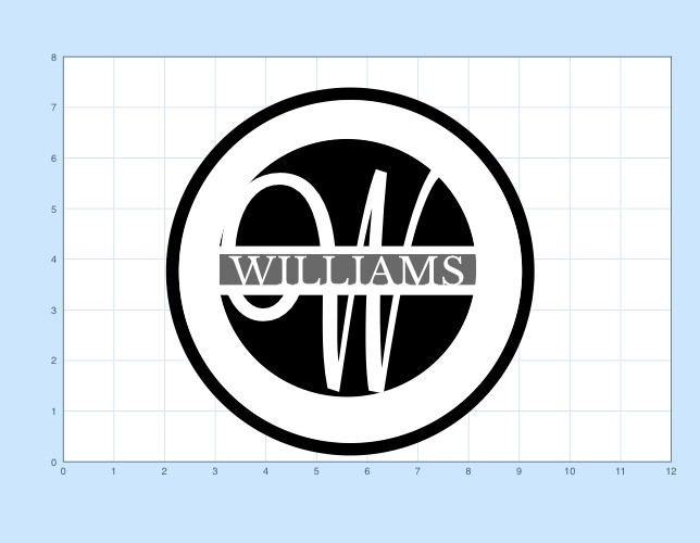

Does anyone know how to make this design? I’ve got a friend who wants me to make it for them and I’m a little stumped. Just as an FYI all I’ve really got access to is Easel and Inkscape. Thanks for any help!!
Pretty straight-forward.
Place the image on a locked background layer in Inkscape.
  • Draw the circle, the two horizontal bars and union them
  • set the text and union it
  • draw the outline of the monogram letter — suggest drawing in the whole thing, ignoring the gap of the name area
Save the file and duplicate it and open the copy (just in case someone wants a copy of the monogram letter)
  • draw a horizontal bar to mask off the monogram letter, subtract that from the letter
  • union what’s left of the letter with the everything else
If you want to use Easel, font selection will be limited. I put this together in a few minutes.
I probably used one too many shapes but it was my first time doing this. It is possible with Easel.

If you plan on making more than one you can buy the svg for the whole alphabet on Etsy. Just search something like split monogram svg. They are only like $2.99 for all of them and then you can just use easel to add whatever border you like around the letter. Then just add text across the middle. This is how I’ve been doing them it’s very fast and easy.
This! I didn’t even think about that. I have the vine monogram font I’ve purchased the svgs for but I didn’t even think about getting it already split. Thanks!!
