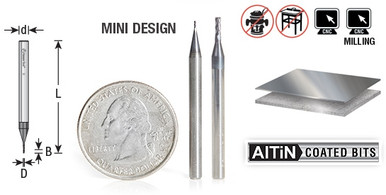

You could also go super small endmills…
BUT you have to be absurdly careful with your feed/speed… and even just general handling. I’ve broken a lot of bits with the collet wrench
That’s funny, I actually ordered that exact EnPoint bit a couple of days ago, hoping it would solve my problem with the fuzzy edges (which aren’t really evident in the pictures above). It should arrive tomorrow.
And I’ll bookmark those mini bits, thank you.
