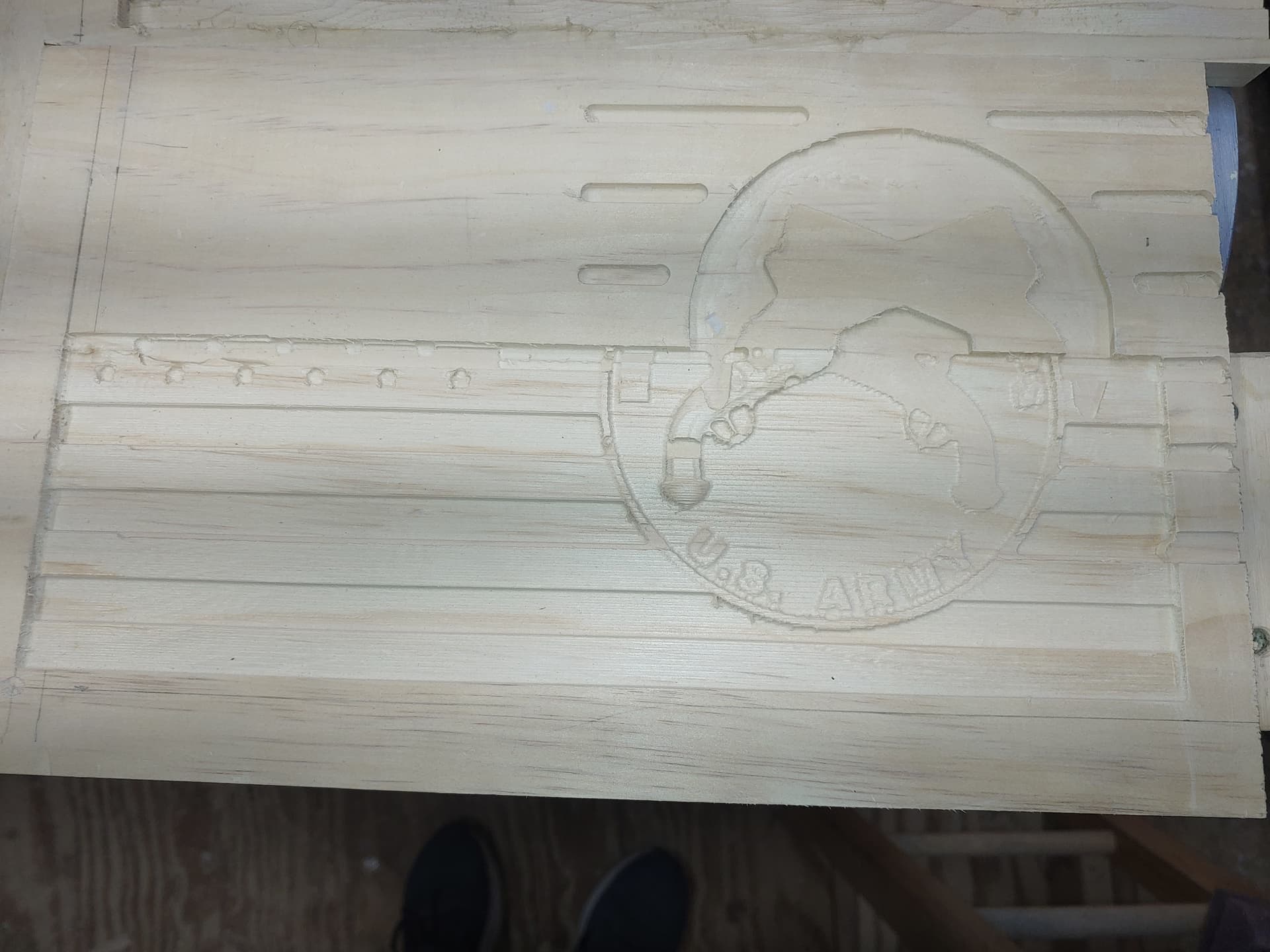

Detail Pass is smaller/scaled down/'squished' from Roughing Pass

The stripes in the wavy flag seem to get smaller and smaller as it goes up.
Any other ideas? I’m at a loss.
Made another attempt, Candle estimated 8 hours for the detail pass. 5 Hours in Candle shows that the carve is starting to carve in the stars. Seen here:
However, this is where it actually was…
It crammed 65% 9" tall flag into a space of 1".

Though I think you may be right about the Y-axis not moving correctly, especially as in the first flag photo from today, the stripes get smaller and smaller as the carve goes up the Y-axis.
So after a bit more experimentation, I noticed that when the spindle makes the sudden y axis movement at the end of the run, the Y2 (Right) Step Motor moves very tight, sudden and accurately no matter which side the spindle is on during the Y Movement.
Meanwhile, the Y1 (Left) Step Motor seems to move exactly the same but ONLY when the spindle is on the right side of the machine during the Y Movement. When the spindle is on the Y1 (Left Side) during the Y Movement, it appears as though the Y1 motor is ‘attempting’ to move, but rebounds back. As if the motor did not lock into the new Y position and returned to the previous.
