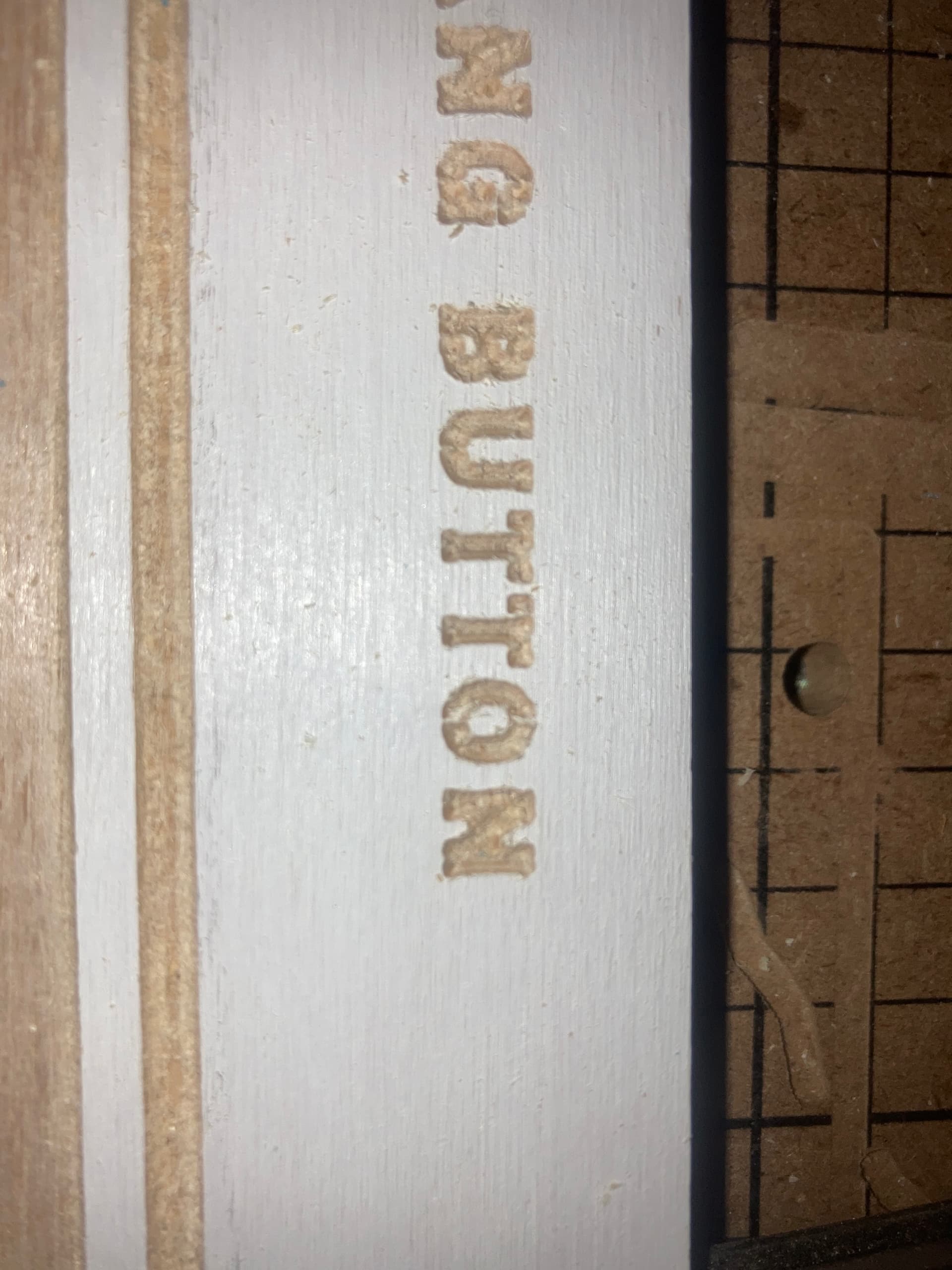

Divots in the corners
Anybody have any ideas as to why I’m getting these little divots in the corners?
Belts are tight, and the V wheels are snugged correctly.
This is a 60° V bit and the angle is correct.
I have used it before with perfect results.
Lack of rigidity, the bit want to pull sideways when cutting.

This is an issue with the z-axis flexing or deflecting. Reducing your depth per pass will help out a lot!
This is interesting.
I’ve checked everything that I can think of, and all appears to be tight.
As far as the Z, I replaced that with a linear slide a couple of years ago.
I can find anything wrong with it either.
I do a lot o V carving and this started just this past week.
If the V-bit have a flat spot on its tip (very common) regular Z-probing will result in the bit going deeper (thus cutting wider) than intended.

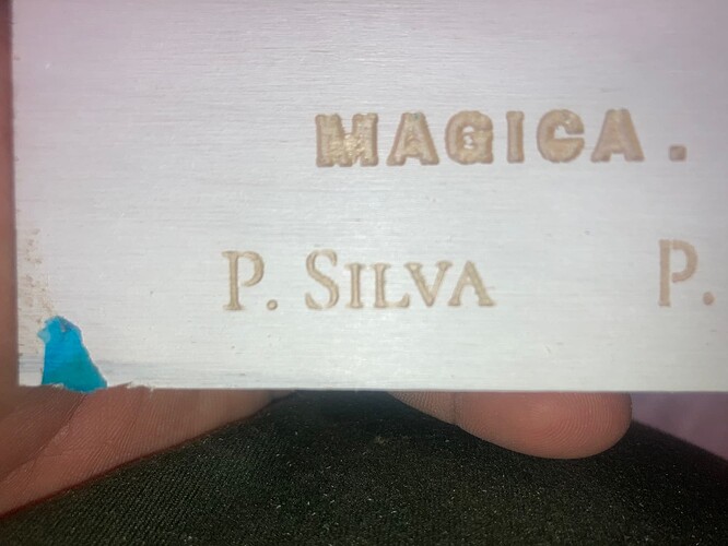

I had this kinda issue with text with using pro it would carve the whole letter then put little dots on the corners for some reason, I wanted to use the v bit to save time but ended up ruining half sheet of plastics and haven’t used the v bit again

My thought is that looks like MDF and it dulls bits quickly. And a dull bit will introduce more flex in your machine. Also a dull v bit might have a slight flat tip.

There is actually nothing wrong with the machine. If you do not want the little divots then you need to not cut so deep when using a v-bit. The v-bit is tapered yet still has capability to cut from the very fine tip to the larger diameter of the top of the flutes of the v bit. So if you have a .125 v-bit that has a .002 tip and you tell it to cut .1875 deep you will have a divot that is the diameter of the v-bit .1875 from the tip which is much larger than the .002 diameter at the sharpest point. I hope I explained it well enough
This appears to me that the code is telling the bit to cut ON instead of Outside the tool path at that point only. I would look closely at the vectors in those corners. There appears to be a half of a circle in each corner.

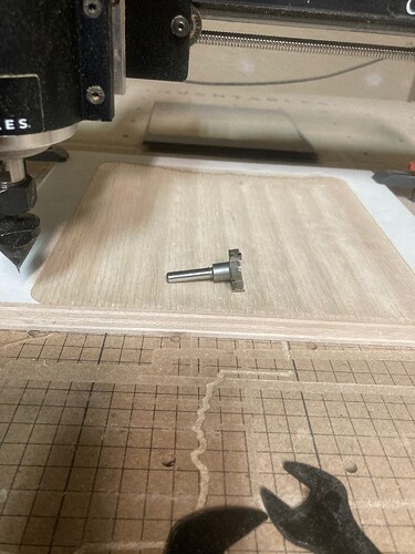

Is that a carbide insert v bit? The angle might be off, like a carbide that isn’t centered perfectly. You can spin the bit by hand while creeping down to verify a tiny point is the result as it touches the wood…
I Also see they your have converted it to a lead screw x and id bet the yes also lead screw, have you checked the backlash and adjusted the antibacklash device?
