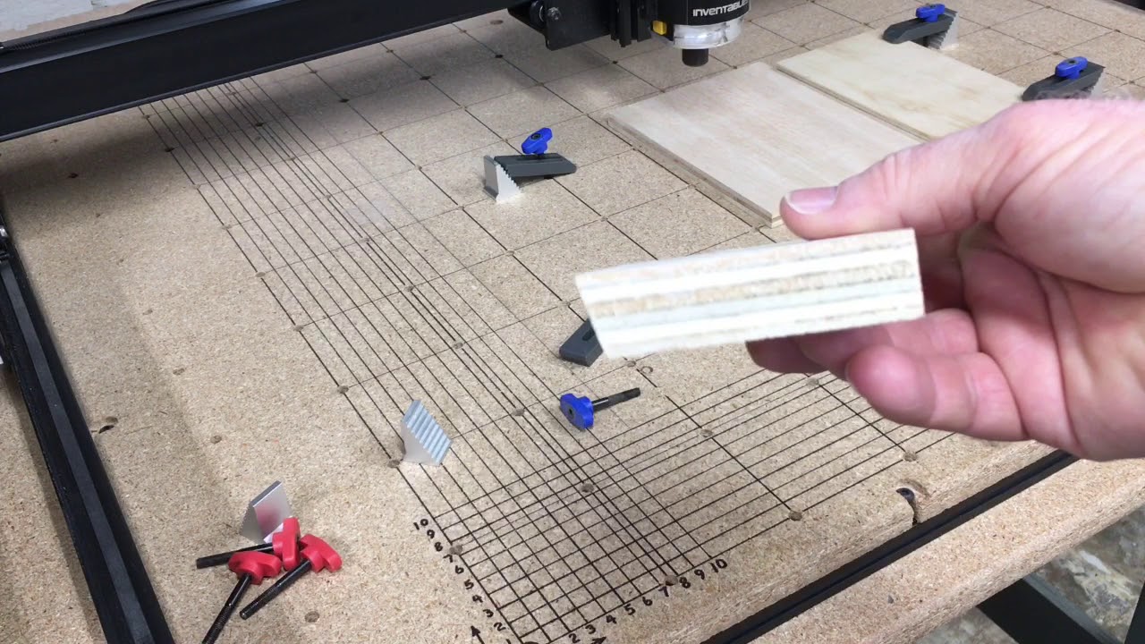

There are several different approaches to Bump Stops. I use two strips of 1/8" white melamine (tempered hardboard) screwed to the waste board. I cut three elongated screw holes in each to allow adjustment. I first attach the Y side and align it to the Y path. The X side is then aligned either with the X path or more quickly by just using a framing square. Then set G28 at the inside corner. I do have about a 3/8" circle cut out at the corner for clearance. (Same idea of Phil’s dog bone). Drawing below to better explain.
Why I like this - 1. Readily adjustable for fine tuning. 2. Low profile which allows easier clamping of thin stock and allows better access for the 3 axis Triquetra touch plate. 3. I can remove the X guide for longer work pieces but still have the Y guide in place for use. This also allows a quick and accurate reinstall using a square. 4. I can write on it with a pencil or dry erase pen and it is easily erased.
