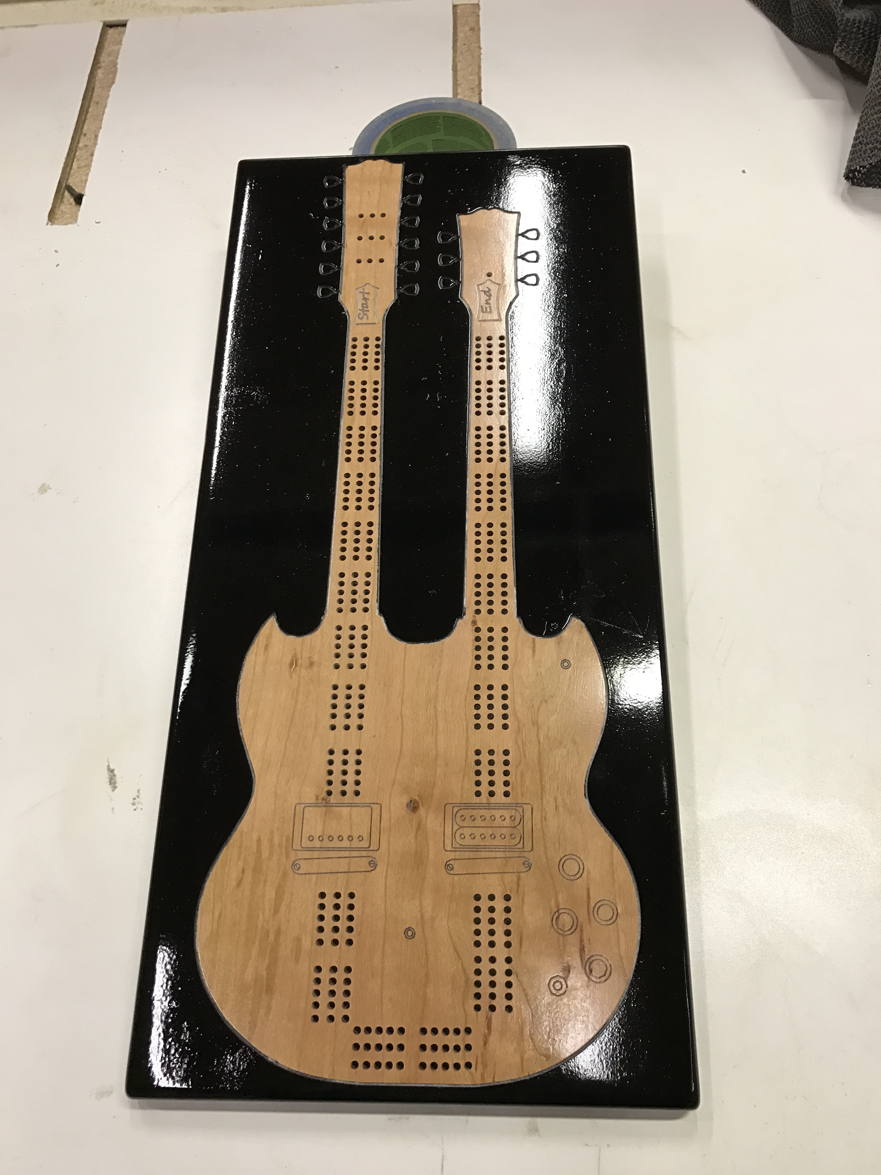

Double neck cribbage board
Almost done, still have to paint the tuners and the outline white and put a clear finish over it. I might make a guitar case for it as well. Anyone have an idea what I should charge for it?

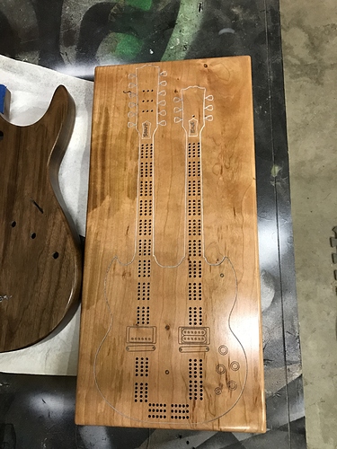

@RobertCanning I started with a piece of cherry
Here is another take on the double neck crib board, this time I cut it out completely (with my new band saw) did the tight stuff around the tuning keys with my scroll saw and then I took some 80 grit sand paper, cut into 1/2" width wrapped around the scroll saw blade with a drop of super glue top and bottom, and sanded in between the tuners and it cleaned up really nice!
