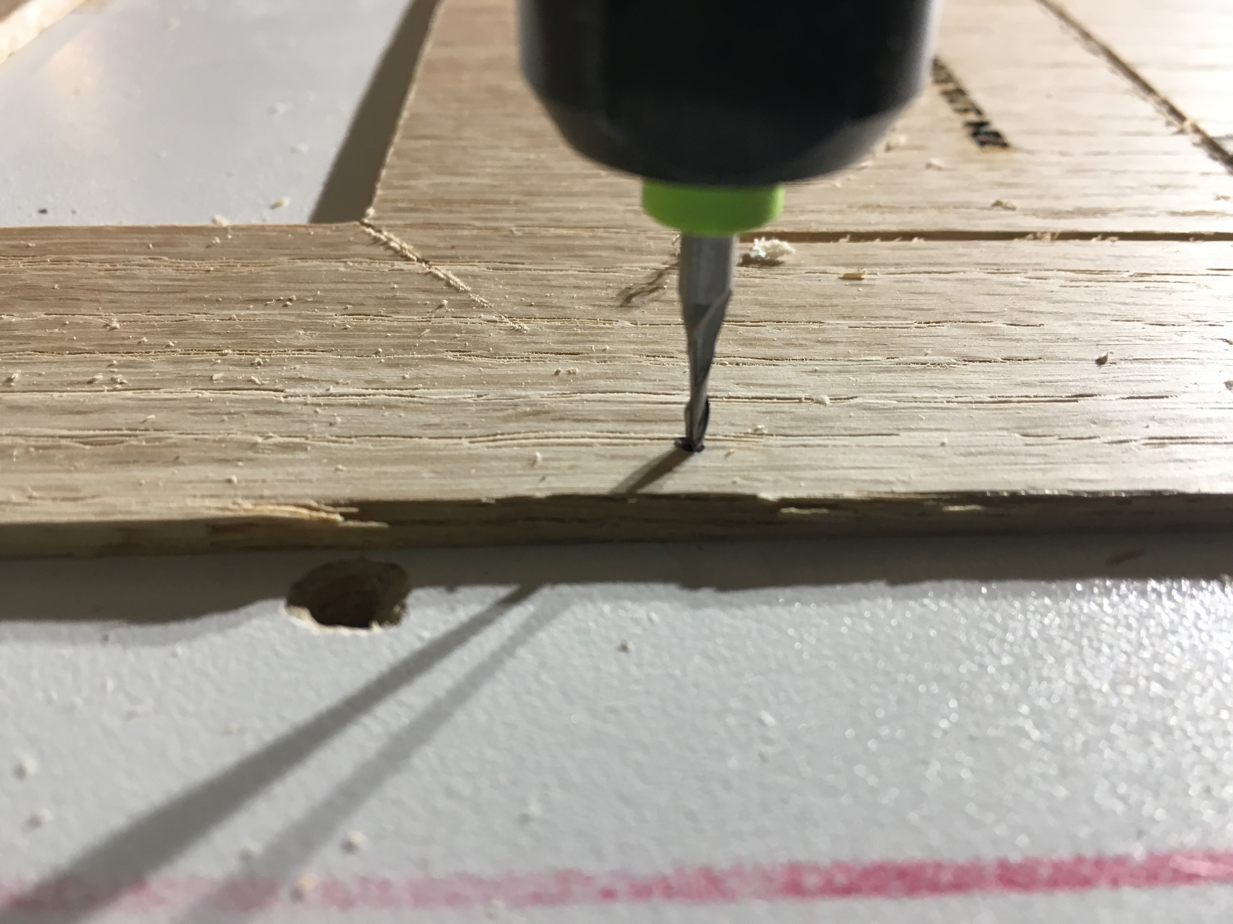

I then took off the mount then added my bit. I went with a .0625 bit. (Mine was .059 with calipers). I then put bit in middle of my dot

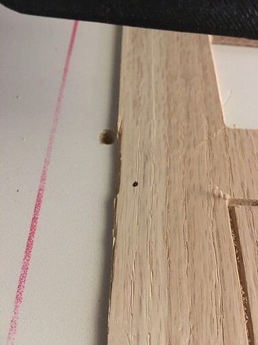

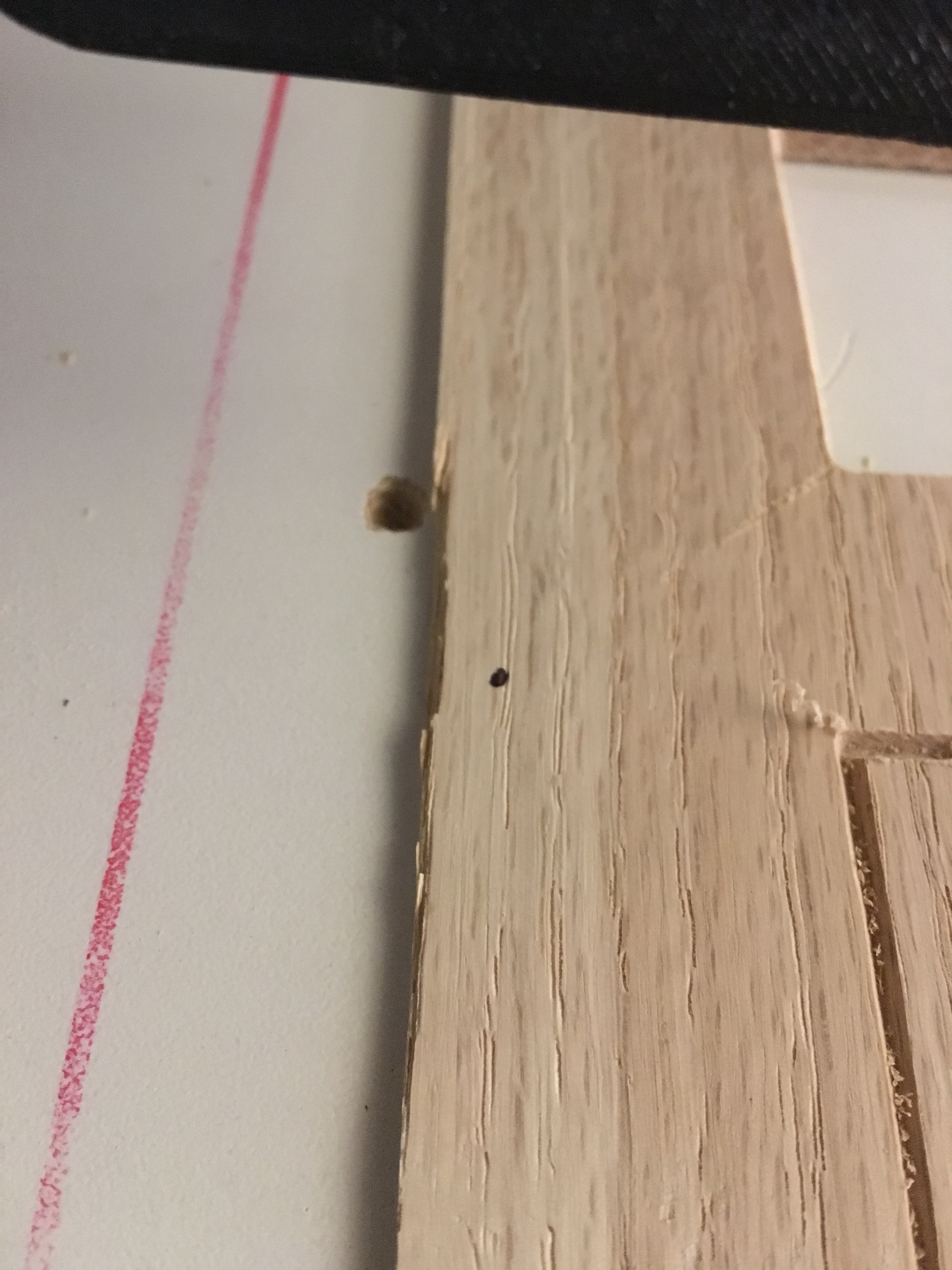

After I had a right angle on my wasteboard. I aligned laser first in corner then slid the work piece underneath and measured the 3" from heat sink
Here’s photo before sliding work piece underneath

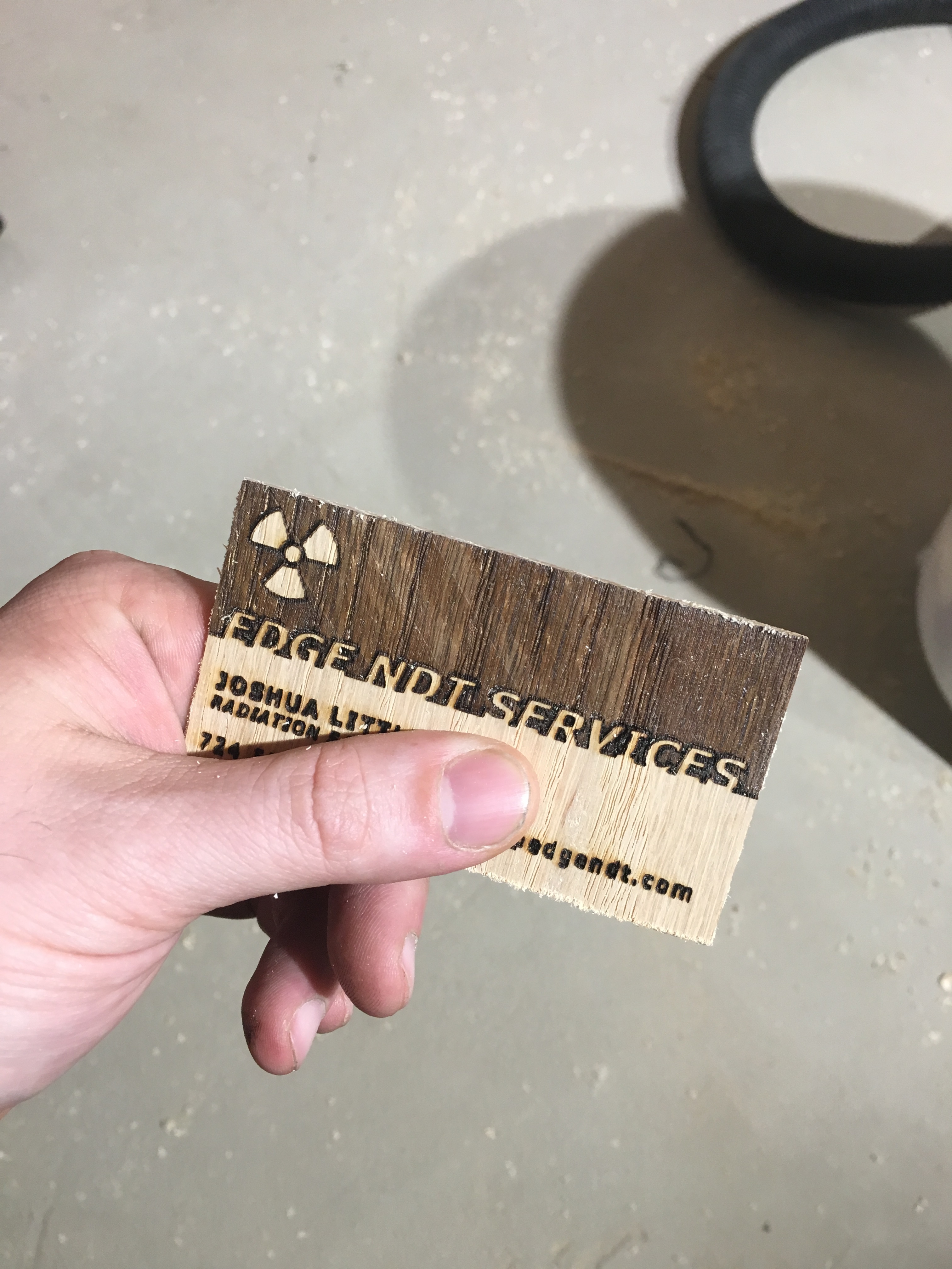

After just a little sanding and boom!!! you’re done. There’s prob a ton of easier ways to do it. I just did it this way because of less screw up on my part.
