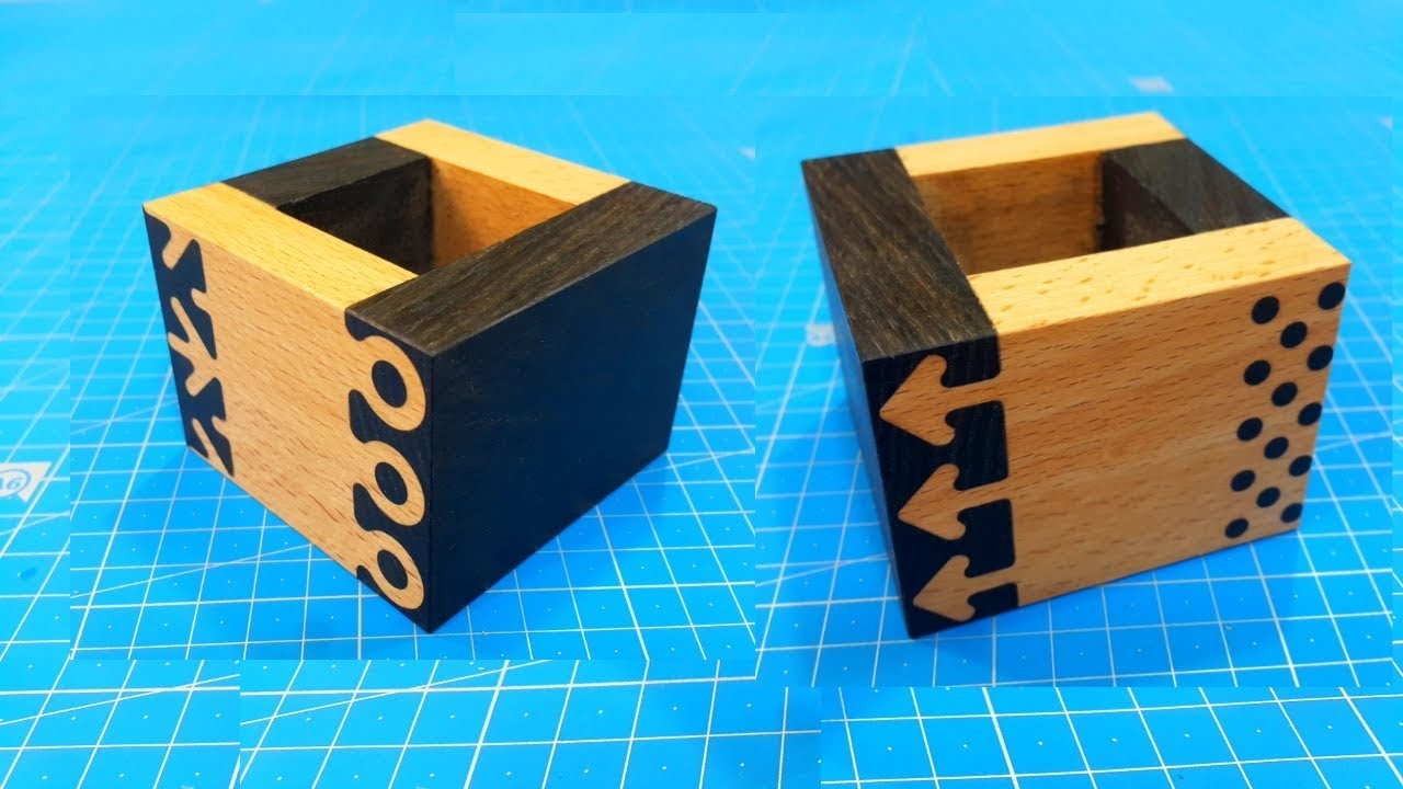

This youTube video shows what you can do with a straight bit to make various interlocking joints which are like dove tails. Again, you will need to carve on one board that is horizontal and another that is vertical.
There are ways of carving finger joints on a CNC with all boards horizontal.
