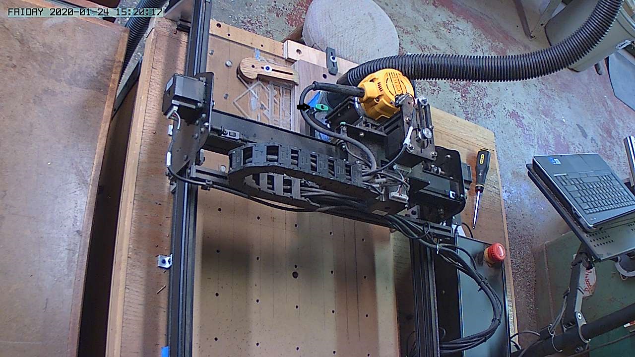

My dust boot has gotten hung up on clamps and slipped off many times. I just do not trust the magnets anymore.
So I taped for M5 bolts and used 2 clamp knob from the Inventables kit. Works great.!

Great idea. I think I’ll do the same but use a quick release pin like this.
