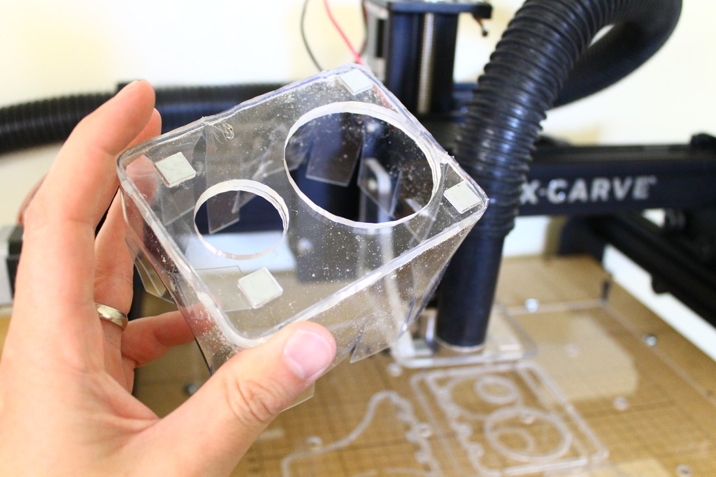

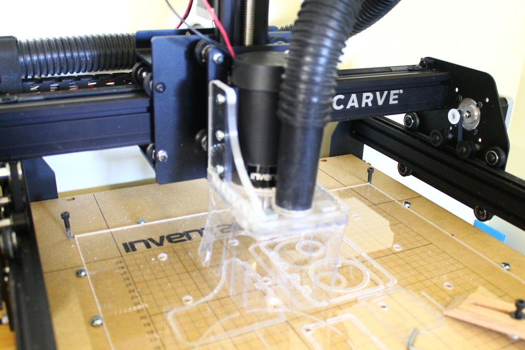

Hereā€™s mine. It was my first project and I rushed it so I could work on another. I assumed the cut diameter of the bit I was using was as advertised, so I needed to file the teeth a bit to get the parts to fit.
I used hot glue for the vinyl, which works great. I also used it on the joint, which is coming apart and I will use weldon.
SVG files below, right-click save image as.
If you use these files, mind that the teeth are drawn to exactly match (no gap). Also you will need to modify the vacuum hole diameter and the shape for your magnets. You also need 3 M4 screws to mount it, magnets, vinyl (mine measures 0.025" thick. 2.8" high, with 1.3" long slits cut with scissors).
All parts are 1/4" clear acrylic. Iā€™ve been using the 1/8" single flute upcut spiral bit, feedrate of 100in/min and 0.01" passes, with good results.
Overall it works really well. Larger, heavier chips donā€™t always go up the vacuum right awayā€¦Iā€™d say it leaves behind about 5% of the chips when Iā€™m cutting acrylic, but the left over mess is small and almost completely contained.
What are the magnets for?
For two-piece dust shoes like @SpencerShepardā€™s , you typically have one piece attached to the machine (the left two images), and then a removable piece with skirting (the right image). This lets you easily remove the bottom section to change out the bit.
thats awesome. thanks for the share! iā€™m likely going to be trying out your design with my xcarve once it arrives. how did you attach the mounting bracket to the top plate? is the motor hold fit exact to help with air pressure escape? acrylic cement?
I used hot glue to attach the skirt to the bottom plate, which worked really well. I decided to see how well hot glue would work on the acrylic joint. I needed it together for another project and didnā€™t have my acrylic glue at home. Unsurprisingly, it is coming apart after a week. Iā€™ll be redoing that joint with weldon for acrylic (I forget the numberā€¦I use it all the time but donā€™t have it with me).
The hole matches the motor well, but sits about 2-3mm below the spindle holder. You could modify the bracket to raise it up a bit, but Iā€™m not sure it matters too much.

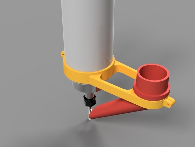

I really like this setup Don. I had been considering something in locline, maybe one as a blower with a tight nozzle and a bigger pickup on the other side with suction. Even if the suction didnā€™t catch everything it would hopefully blast stuff out of the current milling groove.

Iā€™m liking something like this, tooā€¦
I tried holding my shop-vac close to he bit like this before I made my dust shoe. It didnā€™t catch very much. I would imagine the effectiveness really depends on what youā€™re cutting and the size of the chips. Larger, heavier chips are going to be thrown away from the bit with more force than the vacuum can overcome.
Definitely depends on what you are cutting. Following the cut with the vacuum nozzle while cutting acrylic seems great.

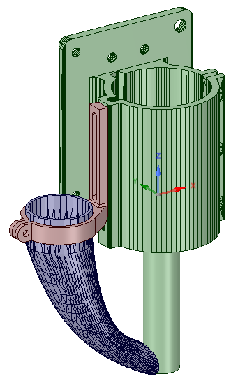

Best way for me was to get a T connector with a ā€œscrew-inā€ 3/4 female end on one leg of the T (Its called a female NPT). Then run the loc-line off that female end positioned at a right angle above the spindle (Should just screw right in) and then a 3/4 to 1/2 reducer off the other leg of the T going straight down parallel to the spindle. Then hook about 5-7 inches of 1/2"PVC , then a little 30 degree elbow at the bottom. For the mount - Take a piece of PVC large enough for the 1/2" tube to slide inside and drill pilot holes aligned with the mounting holes on the spindle. You will need to drill larger holes straight across from these so you can get your bit driver through the tube and into the interior where the fasteners are. Just Dry fit these joints, no need to glue and seal, it will make installing and removing easy too. Ok back up at the top to hook into your vacuum hose I suggest you just take the hose with you to the plumbing supply and have as associate help create a union that will adapt from the 3/4 leg off the T to the size of your vacuum hose.
The reason you do the dual tube is to reduce the chips that escape that people are mentioning with that other design. Having suction from both sides make a huge difference. The reason you fashion it to slide is so if your tubes contact the workpiece or clamps the whole thing slides up out of the way instead of messing up the workpiece by throwing off the spindle. these other designs are great but as your bit depth changes they do not allow for adjustability and clearance. Plus the ā€œshoeā€ type designs are hard to see the bit clearly, even the clear ones. I made a few spacers for "standard bit depths to get the vacuum tubes just above the cut. (More on that is outlined above).
Hereā€™s what I have so farā€¦
like the design. my only concern would be the shoot hitting the material or hold-downs ā€¦ thoughts?
