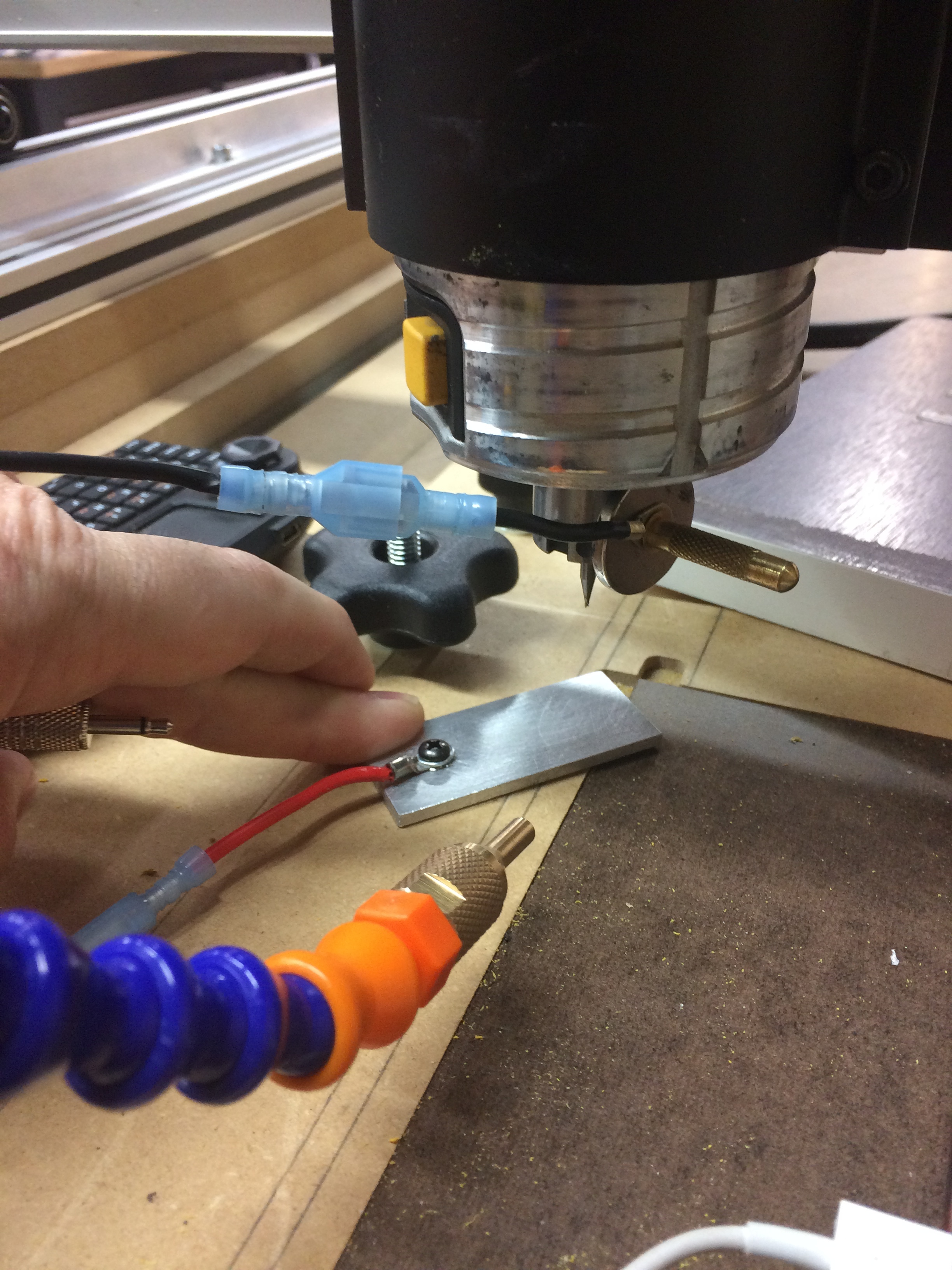

Will be making a new zero plate soon. This was just a piece of scrap that I had around.
