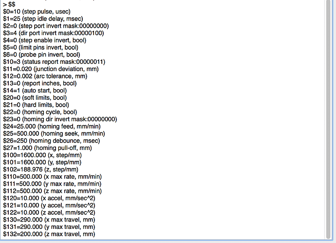

Post your $$ grbl settings
My current GRBL settings:
Yeah, judging by this you went through the easel setup and erased the settings for your machine and replaced them with the x-carves settings. you need to re program your card with the original settings the company gave you for the machine. Mostly it’s your steps 100-103 that are the biggest issue
