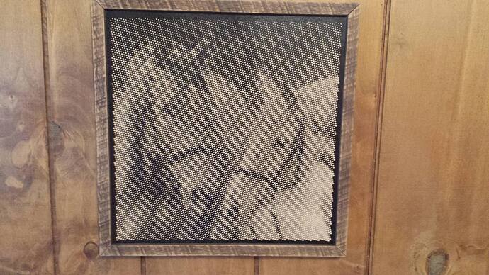

I have been playing around with this program for about a week now. It works pretty well. Should have some vids of the carving up later this week.
Been playing with that program since the days of the Shapeoko. It works very well once you get a handle on how to set it up.
8x10 sized image.
looks good what is the doc
Do you have any tips for what makes the best settings? What type of bit works best?
I used a .2mm 30 degree V bit much like is used in PCB trace milling. It honestly has been almost a year since i played with it. But due to the passing of a pet, we will be working with it in aluminum shortly. I will try to relay more details shortly.
