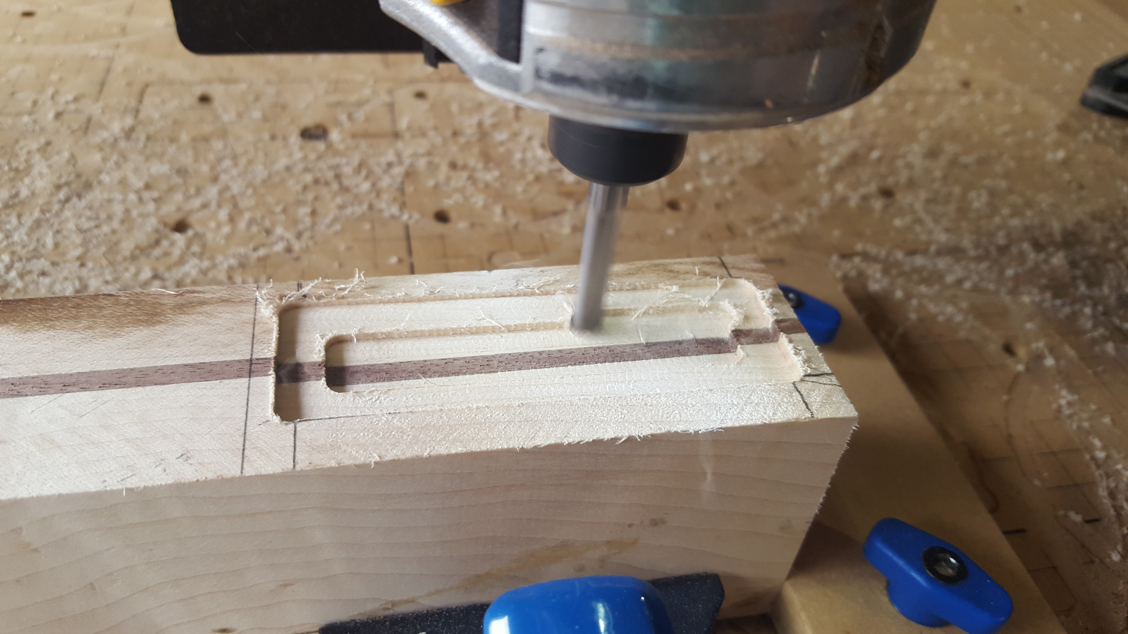

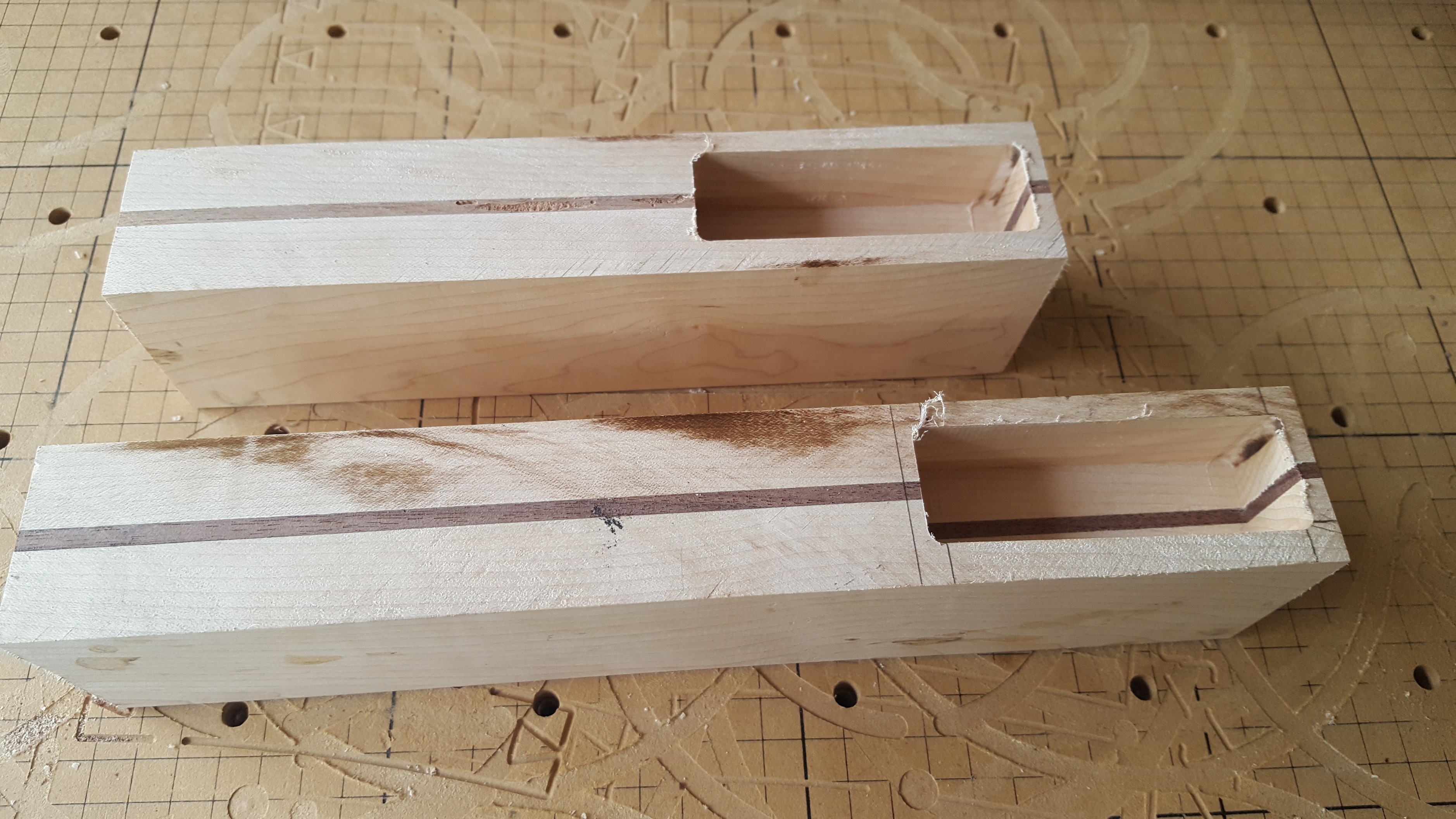

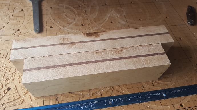

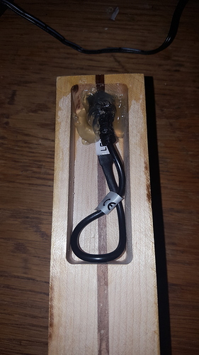

Well, I finally finished these things yesterday. Been WAY too hot in the garage the last month or so.
Anywho, I don’t know what changed, but I fiddled with the settings and got both down to about 3 minutes to carve. Here’s a few pics of how it all went. Ended up making one for my girlfriend’s son at the last minute. I used a 1/32" bit for his, came out super clean. The other two were with a 20 deg. V-bit
Very nice.
Thanks. Sorry the pictures were out of order, I just selected the ones I wanted and ran with it.
Where did you get your led kits at?
I got a spool of LED from amazon, as well as the connectors and power supply. Really easy, you just cut them to length, clamp on the wire connector (no soldering needed) and plug it in.
