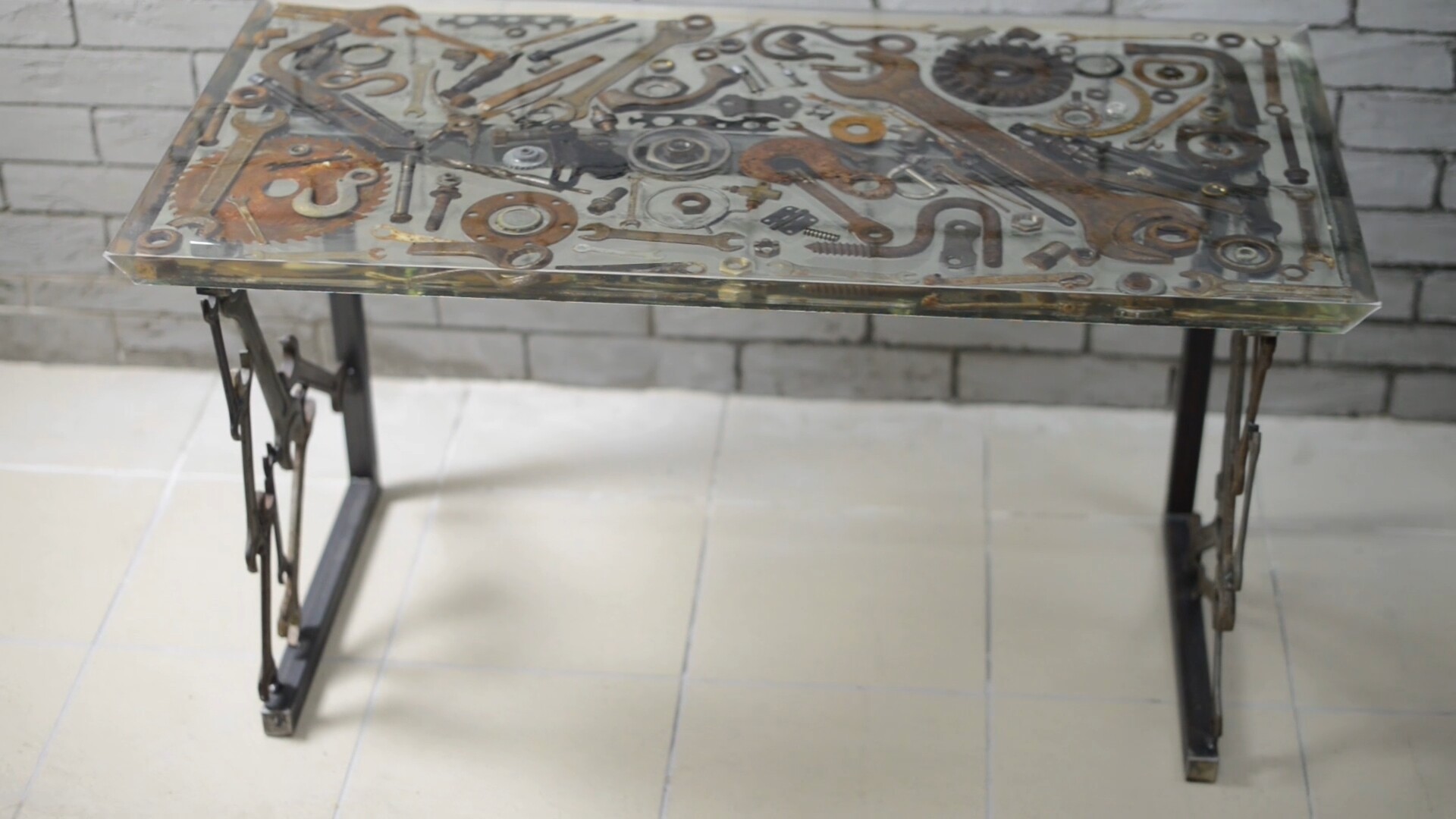

Hi, guys! I want to do the table, but my main problem is that I don’t know which epoxy I need to use.
You said about West System epoxy and VViVid. And I read a lot of sites and articles. There is some information about epoxy on the wiki and I think it is true. See this article - Epoxy - Wikipedia. There are two links in this paragraph. Is it good epoxy? Or recommend the epoxy that you used, please.
I forgot to say what I want to do…
That is my first work with epoxy (in that scale) and I want to do something like that. I want to connect wood, iron and epoxy, and mb something else. Filling thickness approximate 1.6-2.4 in
And I don’t know how epoxy adhesives with iron.
I am new to the carving world, I have done some epoxy work with tumblers. I am curious if anybody has used this with wood. UPERCLEAR EPOXY Resin Crystal Clear 2 Gallon. I got it from Amazon have had a few issues with bubbles before. But haven’t done a big pour yet.
Thanks. But I found another epoxy - Casting Epoxy Resin | Clear FlowCast® from EcoPoxy
One guy recommends it to me on one forum. And he said that I can use mechanisms from old unnecessary appliances. That’s exactly what I wanted to do. I have already disassembled my wife’s embossing machine, vacuum cleaner, and TV. So far, I’ve laid it out and I’m thinking about which of these parts to use.
