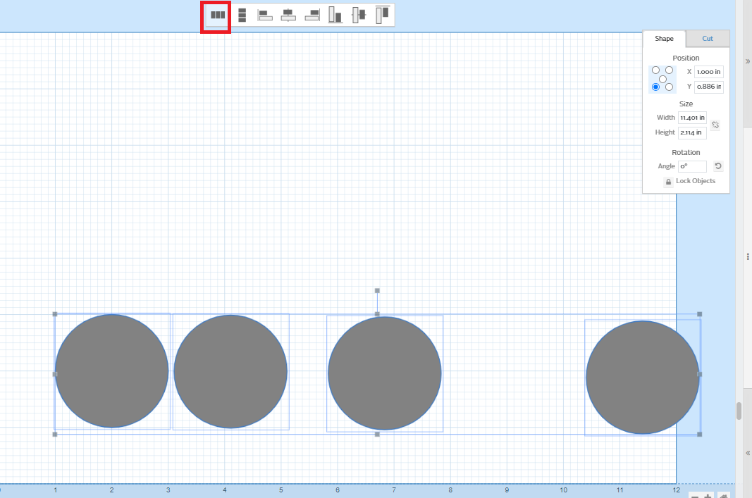

I am making a lathe tool holder. The bottom ‘shelf’ will be 19" long x 2" wide x 1" thick. I want to put 1" circles down 3/4" deep. I have spent the last two hours attempting to get the dozen circles equally spaced (it would have helped if I had paid closer attention in High School math class). In this day and age of computers, one would think that equally spacing these circles would be simple. It has proved to be anything but. I attempted to use the “Equal Spacing” app in Easel, but that just screwed everything up that it erased over an hour’s worth of work. I watched the old (2022) video on using the spacing tools, and those tools do about everything EXCEPT “equally” space the circles.
Is there a tool that will actually space the circles equally apart from one another?

It does exist! Simply select all items and press the “Distribute Horizontally” button at the top of the design window. Equally, you can use the “Distribute Vertically” feature as well; it is just to the right…
Before…
After…

sorry, just getting back to this. Glad that you showed the example that you did because it shows my dilemma. Note how your example goes off of the work piece. What I was trying to do, but did not have the time for a million trial and error, so I just made the piece too large and cut it down on the table saw.
the goal is equally spaced to the work piece, which means the spacing between each hole being the same distance on each end as well. For the life of me I could not figure out how to get that done. So as mentioned. I spaced them to what I calculated that the needed to be and left several inches on either end, then lopped the ends off to make it work. NOT the right way, but… adapt, improvise, overcome.
what is needed is to be able to equally space to the workpiece, and if it’s possible I couldnt figure it out.
@JosephJohnson1,
Well, one way to go about that would be to create all of your objects and get them aligned how you want them. Then, just group them together, select the center as the alignment location, and change the X-Position to the middle of the stock.
Does that make sense?
