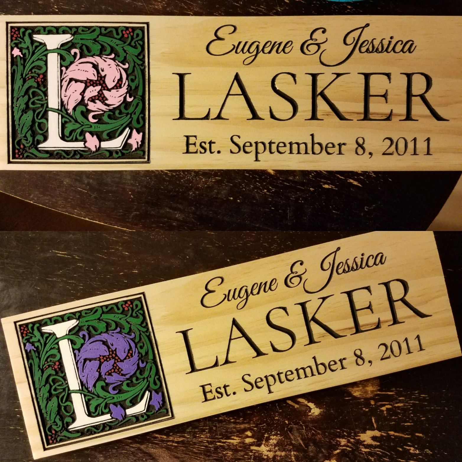

I recently finished this for a co-worker. The letters can be found on Google Images under “William Morris Alphabet Clipart”. I wasn’t sure how it would transfer, but I am very pleased with the results I got. I used Easel Pro for the design and used the Image Trace tool.

Is the entire sign vcarved or a combo?
It was all done with a 60* bit.
@BrandonTreadway so after the carving, did you paint the entire thing black and then lightly sand and then coat with poly? I love the way this turned out for you.
Yes to everything except the poly. I used crystal clear spray enamel from Rustoleum since this is an indoor sign. If you use spray paint, use black primer only. Since this is select pine, I would use some kind of shellac or sanding sealer on the board before carving if you plan on spraying.

This is awesome. Great work…I was curious if you used a 60 V bit or something else. Also what was your depth set at? I am having issues with a drink coaster with the Letter B. Any help will be great!

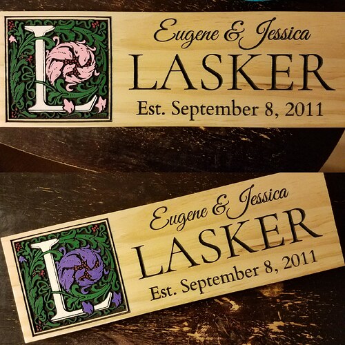

Thanks. I used a 60* bit and the depth was either .06 or .07. Can’t remember off the top of my head. Here’s a picture of another one painted. I would probably choose different colors, but the customer wanted these specifically. She originally wanted pink, but then she switched to purple.
