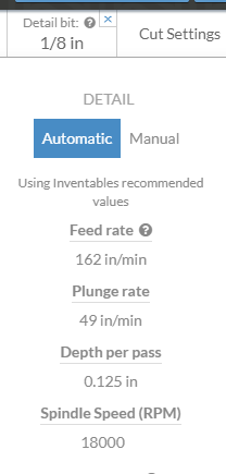

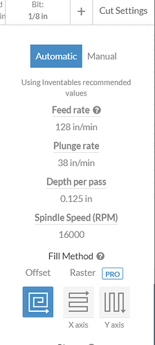

@TCarter Make sure you have “X-Carve Pro” selected from the drop down under “Machine”. Selecting that gives much better automatic settings.
@ZackNeese it looks like you have the X-Carve settings for bits and materials not the X-Carve Pro. Try what @ShaneJamerson suggested.
The machine is capable of 1x, 2x, and 3x the diameter depth per pass. In general you can use Feed Rate = Spindle Speed x chip load x # of flutes for speeds and feeds and adjust based on the application you have. Sometimes you want higher material removal rates and other times better surface finish.
Mine has been set on the X Carve pro.
What bit are you using out of the toolbox? I typically have the 2 flute straight 1/8" and these are the recommended settings I get.
What material are you setup to use?
for a 1/8" bit, the recommended settings vary between
Pine:
MDF:
Now, with MDF for example, there is a “Inventables hasn’t tested this combination of material and bit. You may need to experiment to find optimal settings.” message for that of like MDF, so I suspect the settings are like a low “safe” value for untested materials.
@TCarter that makes sense. I use Baltic birch on all of my designs. I don’t find much benefit in changing away from that.
I had a carve going this evening, cutting 0.706in Birch Plywood with the included 1/4" downcut bit, my apple watch alerted me that it reached 95 decibels during the cut throughs.
It may seem counter-intuitive, but when you increase the feed and plunge rate the spindle is moving faster so you might want to SLOW the bit down. You want to make chips, not sawdust. Look at the waste coming out of the cuts, is it sawdust or chips? It is one of the advantages of the spindle vs a router. On setting 1 (the lowest) the DeWalt 611 is at 16,000rpm’s, the Pro’s spindle can run down to 8,000 rpm’s.
