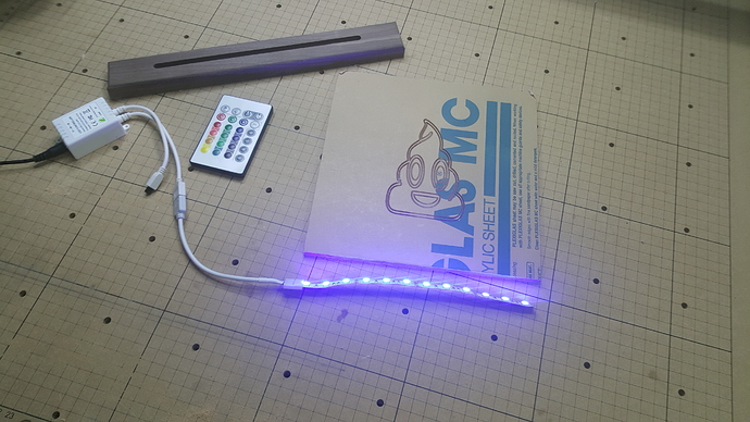

Got a request from a friend to make a set of LED edge lit signs. Made to be able to change out the sign so I can sell them separate from the base.
  • 6" x 6" x 1/4" Cast Acrylic (carved with 1/32" bit, 45IPM, DOC 0.02")
  • RGB LED Strip (USB powered so can use wall adapter or battery pack)
  • Select Pine Base

Gee… You and I have the same idea… it looks terrific. As manner of fact yesterday I bought few led kit from a local vendor with the idea to make these type of lighting fixtures. How do you mount the strip of led?. I do assume that you hide these strips inside of the pine carved stand?. What is the length of strip and the time to carve the acrylic signs?. Again gradulations … Regards
The L.E.D.'s you are using where did you buy them and what size are they???
Here are some other photos of the base. I carve the through slot and inset into the bottom of the base. Install the LED and then apply a thin foam sheet. This covers the LED, gives a nice 2 tone look, is inexpensive and protects the surface of whatever you put the sign on.
@MikeStinger LED Strip: https://www.amazon.com/gp/product/B01ICVGJG2/ref=oh_aui_detailpage_o01_s00?ie=UTF8&psc=1
@AlainGauthier Its 5-12 minutes for these particular signs. The strip is hot glued into the bottom groove.

If by color comtrol you mean I can define a sequence of color changes which I define, awseome and please share where to get them. To date for this I have using an Adafruit trinket and smd5050 lights for intricate per light patterns on numerous projects
Robert… matter of interest, see picture of my first kit using acrylic and Led kit system. If you buy a led controller along with the remote control and the RBG led lighting you have a variety of color scheme. As you can notice, the protective paper will be remove when I complete the construction of the lighting fixture.
