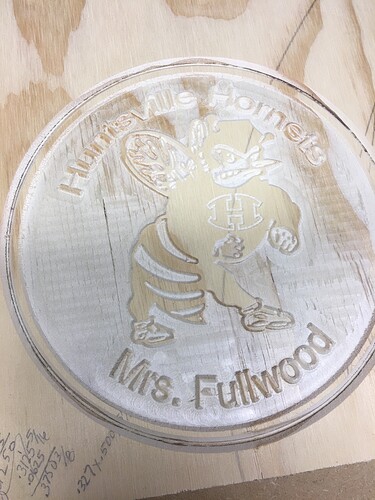

Brand new user, this was my first real project. I did numerous test cuts and thought I had it figured out. I tried to make a small little sign for my wife at her school. In Easel Pro it looked ok, I didnt see any issues, but the finished project was less than appealing. I used a 3/4 in flat bit for roughing which you can clearly see was mostly the left and right, then I used a 90 degree V bit for the rest of the detail.
I am confident the problem is something I did, just not sure what.
Here is the project:
Hornet Sign
I would greatly appreciate any feedback on what I did wrong.
Is there a reason you used such a massive roughing end-mill? A 1/4” or 1/8” should rough that no problem (that looks like pine?). The problem I see is that the roughing bit can’t “fit” between the letters and the outside of the pocket. The v-bit thinks it only has to chamfer the letters. So try swapping the roughing to a 1/8”. You didn’t show us what easel said it would do, but assuming easel didn’t say it was going to clear to the left of the circular text, then that’s because it can’t fit the end-mill in there. Your sign would have to be massive to get a 3/4” end mill in there. Also from a shear stiffness standpoint the x-carve isn’t super rigid to pushing a 3/4” end-mill through is going to chatter a lot giving a rough appearance. Also from the look of the bottom of the pocket where it did carve, you may be a out of tram? (I.e. Not vertical either left/right or more often front-back).
So it is important to realize what easel does between roughing and v-carving. If you use the v-bit as the finish pass it won’t try to pocket with the v-bit, ironically if you had skipped the 3/4” machine would have gotten closer to what you wanted by painfully clearing the pocket with the v-bit (which for large areas, never quite looks right). Personally for this I would use a 1/8” down cut for the roughing and 60-degree for the finish.
Thank you for the response, your comments make perfect sense. The only reasoning to anything I did, was just pure ignorance on my part, there was no method to my madness. I will take your advice and re-do this. It did appear to me that Easel never tried to get the 3/4 bit up above those top letters, but again, I am possibly just missing that part.

Did the roughing bit leave those ridges on the hornet and on the outer circle?
That dont look right.
I ran your file on some plywood. You can see after my roughing that I don’t have those steps that you have. You’re losing steps, a belt may be loose. After the roughing I put a 90 degree bit in and finished the carve
First of all, THANK YOU. Your photographs saved me a lot of I told you so from my wife about what this thing can do. My investment in this “hobby” so I could make stuff for her was looking a little sketchy with what I was producing, at least I know its possible.
I noticed in my roughing it did those “divets” around the bottom where it just dove down and made little holes. Yes those ridges around the hornet were all from the roughing pass.
I looked at my 3 belts. They all appear tight, you can “pluck” them and they are really snug. Also watching the machine work, nothing looks like its slipping.

Because the V bit didn’t finish cutting the letters and do the detail on the hornet.

I would definitely start with a simple rectangle carved into a board. If that works, do a circle with some plain text, and work up from there. Much easier to debug when things are simple. Did you calibrate your e-steps? That shouldn’t have this issue (since the error would be constant on both the roughing and finishing. I wonder if part of the problem is your roughing bit is too big so the rough pocket is leaving too large an amount of material for the V-bit to cut away. The x-carve is not super powerful and is easy to bog down with too aggressive a cut. If you can get a smaller roughing bit, I’d do so (1/8"). Most often I rough with a 1/8" and then transition down to a 1/16 or god-help-me a 1/32 depending on the job in wood. When I am cutting aluminum or steel on my tormach I would pick a much heftier roughing end-mill (3/8-3/4") to hog out and then drop to 1/4 or 1/8 for a fine pass as I want the stiffness into metal A 3/4" shear-hog can blast a lot of aluminum into chips) but in wood you don’t need that level of stiffness in the tool.
