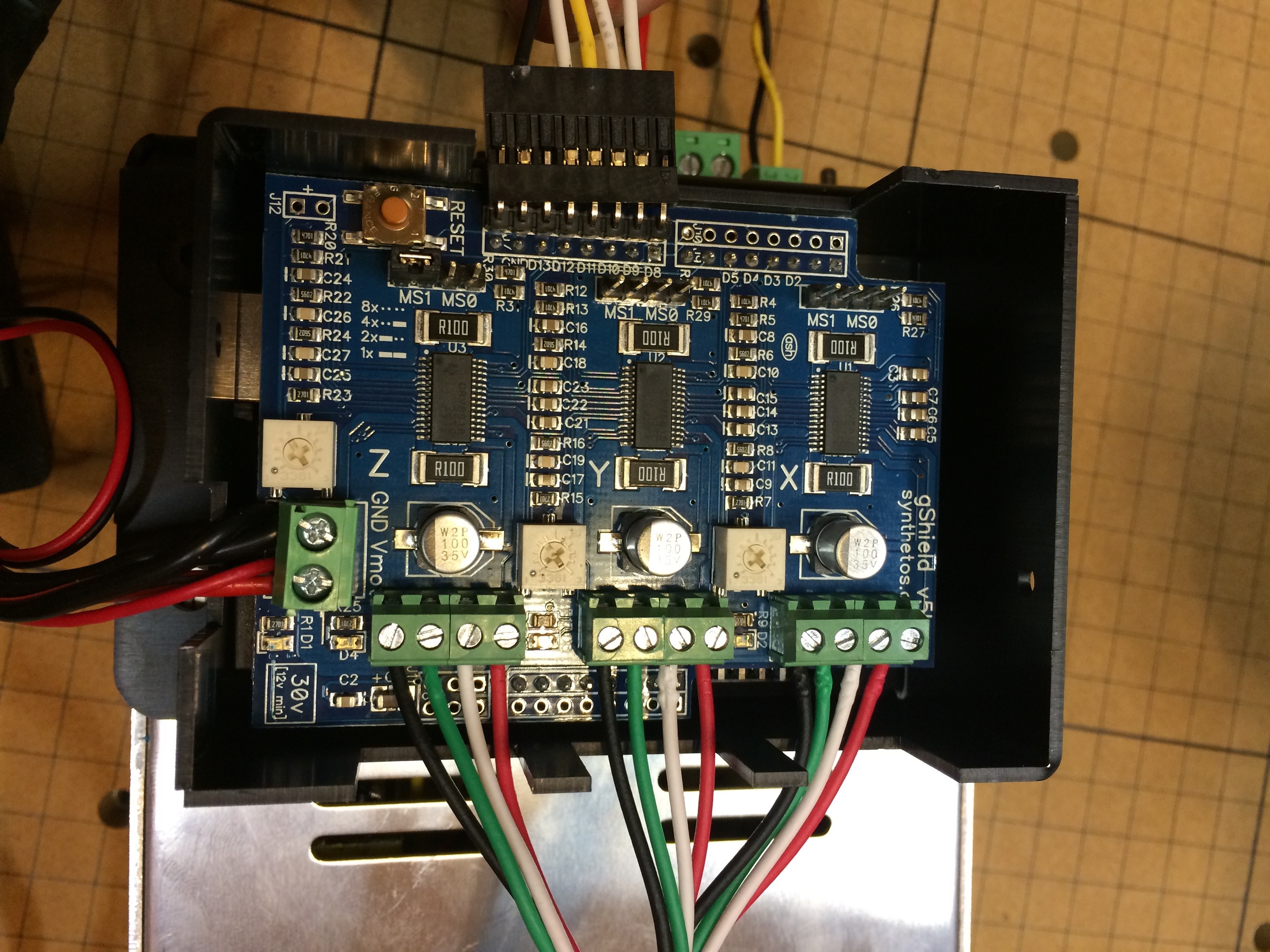

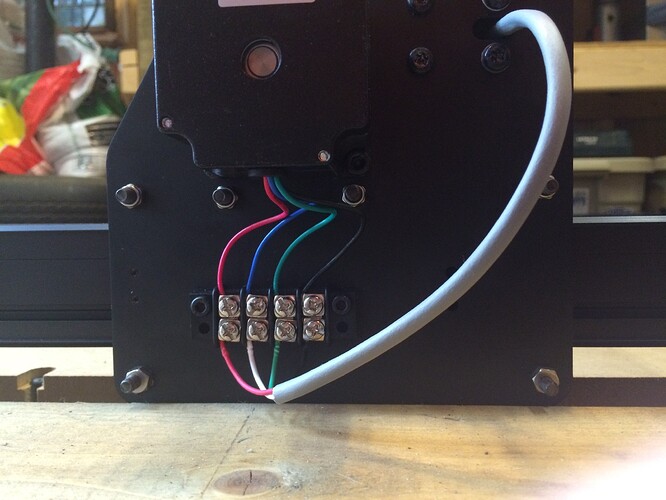

Here is my wiring connections and setup:
Help!

With the USB cable plugged in, and the 24 volt power supply turned on you should have the blue LED and three green LEDs lit up.

The green LEDs should be on. Where did you get the grbl hex file to load into the Arduino?
Make sure that the gShield is plugged into the Arduino with the mounting pins lined up. It’s very easy to plug it in with the pins mis-aligned.
