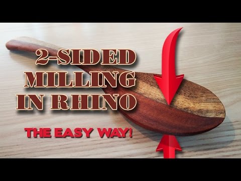

I found this video on youtube that uses the same technique. Heā€™s getting some really nice results.

I made the spoon and an automated script for the flip geometry:
and also that soapdish
I noticed a wood screw + fender washer on the piece after the flip.
Were the tolerances of the cut not enough to keep the flipped board in place?
Oh, youā€™re right. Totally missed that link when reading it the first time.
It seems to me that an app could easily generate the ā€œflipableā€ tabs that lock the piece into place for any rectangular work piece.
fender washer \ screw were so no tabs were needed
better be safe than sorry. It probably would have worked just as well without the screws.
But it prevents the stock from getting pulled up.
Lateral movement was pretty much non existent. (as it should be) also the screws/washers wouldnā€™t remedy that in the first place.
Also, I have to admit i made some rookie cnc mistakes during filming, and didnā€™t want to redo the whole thing, so I edited most of that stuff out, because it was a proof of concept. But yeah there are still some suspicious activities going on if you really dissect every frame of it :slight_smile:
yeah, iā€™d even be willing to adapt the script to easel for instance, canā€™t be that hard.
But I never use easel in my life but from what Iā€™ve seen I always figured the origin is the home position and canā€™t be set to the middle point of the stock, which is needed for keeping the zero when flipping.
If Iā€™m wrong, let me know, maybe Iā€™d look into it. Or someone experienced in creating easel apps could convert my code to the easel api.
