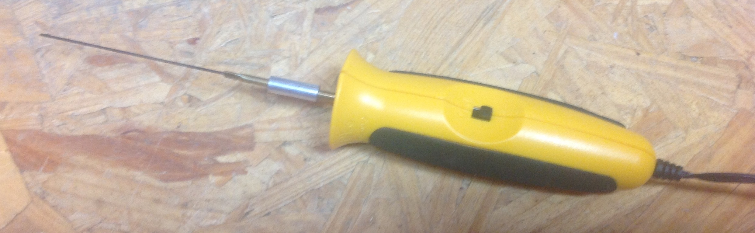

There are hand tools for making plunge cuts in foam, that look like this:
There’s even a CNC version of this tool, that has a mounting bracket instead of a handle, although I haven’t found any references to anyone actually using one. The problem with these tools is that the needle is really, really bendy - you have to move extremely slow (multiple seconds per inch of cut) to avoid damaging it.
As a proof-of-concept, I’ve tried a test cut with this hand tool jammed into the vacuum hose mounts of my old Shapeoko 1. (The machine is nowhere near big enough to do my actual cuts, which are about 22" x 17".)

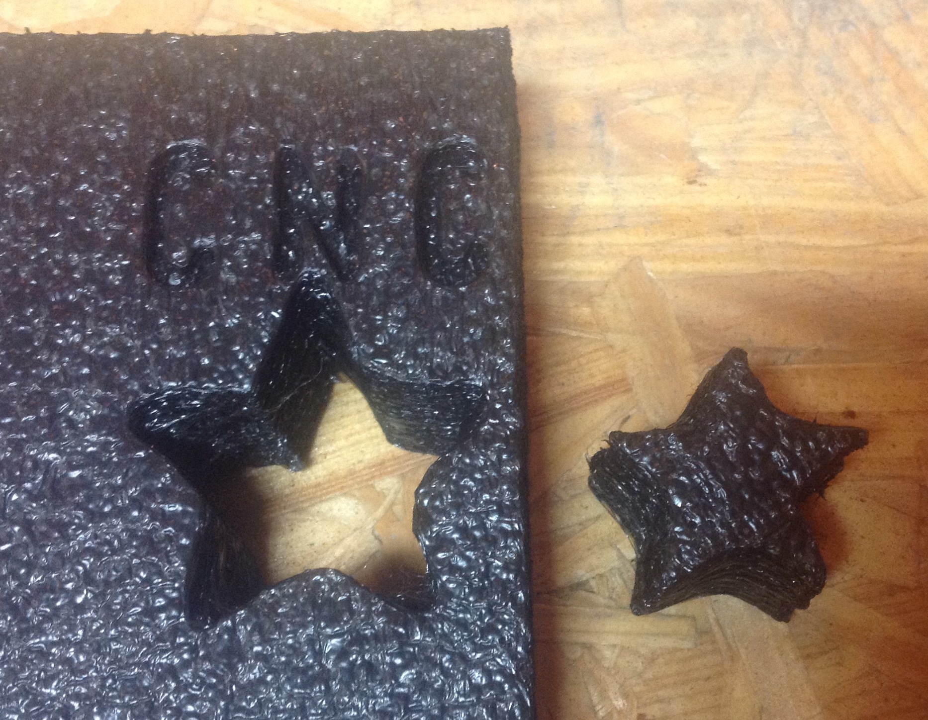

Even with the feed rate slowed down to 5 IPM, the results aren’t great… here’s the top view:
And here’s a bottom view of the 1" thick foam, with even more deflection in the needle. All of those edges in the star are supposed to be straight!
Frankly, I can do a better and faster job by hand. Does anyone have any ideas on how to do this right?

Ok, here’s a try using a regular bit, the 1/8" 3-flute rotozip bit that came with my DeWalt DW660. That’s the only bit I own that was even close to long enough for this test with 1" foam; I’m not sure I’d be able to find a bit in a reasonable diameter that could handle my 1.5" foam.
This worked better than I expected, but the cut surfaces are incredibly fuzzy - covered with loose bits of foam that would easily rub off onto the equipment that will be stored in the Pelican cases, so this isn’t really an acceptable result. I would need some assurance that the specialty foam cutting bits produce a better surface finish before proceeding any further with that idea.
Looks pretty good compared to the first.
Do you have a heat gun? Maybe hitting the cut surface with a quick puff of heat to get it to tighten up would help with the shredded edges?
