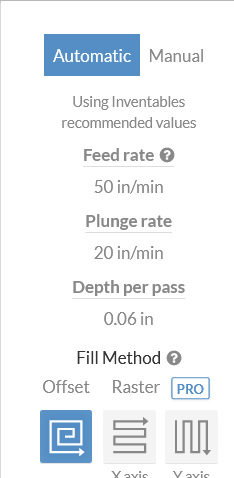

Long time supporter of inventables here. Bought the large x-carve in 2015 or so. Haven’t used it in a year or two. Came back to cut a project and was told in easel that I have to pay for pro to change the size of my mill to 1/4” instead of 1/16” or 1/8”.
Went ahead and paid for pro, is this the only way to change my mill size? I totally understand pro should have well, pro features worth paying for. I use Adobe illustrator to create svg files and the fact you can do fonts in pro is useless to me.

You should not have to use “Easel Pro” to use a 1/4" bit. You likely have something else in the design that is a “Pro” feature. Are you using a V-Bit, Raster Cuts, Pro Fonts, or Pro Design Object?

Nope.when I went to change mills it only gave me options for 1/8 and 1/16. Was cutting a large project and that was a no go from me.
When I changed mill bits it only allowed me to enter the 1/4 as a custom size -.25”. Well, when I Did that, a pop up window told me I had to upgrade to pro.

When you’re in Easel go to the bit tab and you will see under the End Mills you will see other, you can enter whatever size end mill you have. You only need Pro for V cuts, Pro Fonts, Pro Design Library and raster cuts
The reason it may have told you that you needed Pro is under Fill Method you may have had Raster selected, Both Raster cuts require Easel Pro. Offset is regular Easel

Definitely not the 0.25" bit being the issue. I just checked, and it works perfectly fine in the regular old Free Easel. It has to be some other “Pro” feature you have chosen on the design.
