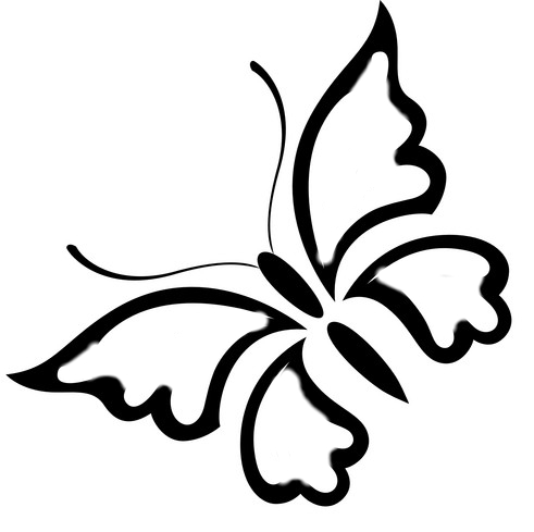

I have corel draw x8 and its driving me nuts that when I export an image as an svg it says that there are bitmaps in it. Even if I convert it to pdf, and open it in corel and try to save it as an svg it still says this. also I get an error when trying to upload to easel. I will try to link the picture. any help would be appreciated.
this is the picture of the upload error
This is the picture I am working with
butterfly1
Before you export you need to make it trace its should be in lines afterwards make combine and do try change colors does it changing colors in corel ? than you can export SVG.
haha! it worked, and was able to upload! thank you. You do a quick trace, move the image, delete the other image and Walla! it works.
