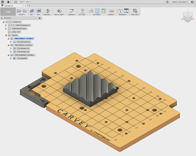

But i am trying to figure out how to set the dimensions for the build area in Fusion 360, so that it accurately reflects the carvey build area. I thought that was the stock setting but it is not.

@BrockMakerspace I’m not sure what you’re asking, but I think what you’re trying to do is set a Work Origin that is away from your model? If so, you can set a work origin to be at any sketch point in your model.
The easiest way would be to create a rectangle 8" x 12" to represent the Carvey waste board.
When you set up your tootpath, exclude or turn off visibility for that object.
Something like this?
(I pulled it of the net a while back)
Yes - this is perfect. if you still have the link I can download it.
@BrockMakerspace
Try this link:
Fusion360 Waste board
Not my work so I can’t claim any credit :slight_smile:
