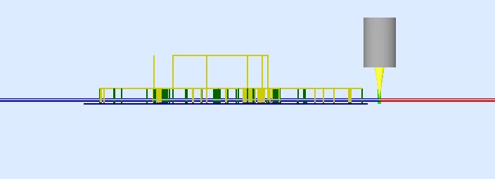

I am a new owner of an xcarve 1000, and completely new to the CNC scene. being an IT guy, i built a simple computer to connect to it and installed things like fusion 360, inkscape, UGS (2.0), and the easel drivers.
in Fusion, i have downloaded and installed the post files for xcarve and easel. I have created a project to engrave a surfboard and letters into a guitar.
I created the gcode and uploaded it to UGS. It looks right, but the tip of the surfboard is 2 inches too far to the right, and the z axis never went down (should be a 1/16 deep cut). i ended up lifting the scratch board that im trying this out on, to see what was being cut.
in UGS the x and y values should be 0 i think, they are -29 (-750mm). even after I hit reset zero, it still shows -29 underneath the bigger number for x and y.
I calibrated the machine using a caliper and the wizard
I have attached as many pics as I can to help illustrate what I have done. where are my errors stemming from?
Do you have home switches? Did you home it? Does it then show negative numbers after homing? This can be an issue, as it is with mine. I end up just closing the UGS and reopening it without re homing it a second time. This is because traditionally, cnc machines had home to the far right, not the near left like the X carve.
I do have homing switches, and yes they are negative numbers when I home. I have tried to disconnect and reconnect but without closing UGS. I just tried at now I see 0s. that resolves that.
the issues left are it going 18 inches to the right instead of about 15.5 inches, and the bit staying at Z 0 instead of plunging into the wood.

Power machine ON, command $H to do a homing cycle (this syncronise machine coordinates with design coordinates)
Jog to my intended work zero position (Click Reset Zero)
Send gcode to the machine and carve
2 - The negative or positive figures are arbitraty and can be ignored. As long as the machine have performed a homing cycle any set work zero´s or parking spots (G28/G30) are stored as offsets relative to the homing switches and are persistent (Untill changed)
So you can power OFF, power back ON and run $H and same work zero is maintained.

my workflow currently with UGS (this is my first cut using it) is to connect, home the machine, and manually move z axis to the work piece. I realize that i didnt disconnect and reconnect UGS after all that and that could have caused my issue. ive played with a few different steps, but still working it out

If you create an sketch in Fusion 360, project the geometry, and then save that sketch as dxf, it will import perfecly into easel and you do no have to deal with UGS.
If you have homed the machine and clicked Reset Zero that position is persistent.
What the coordinates (both machine and work coords…) read do not affect this at all.
