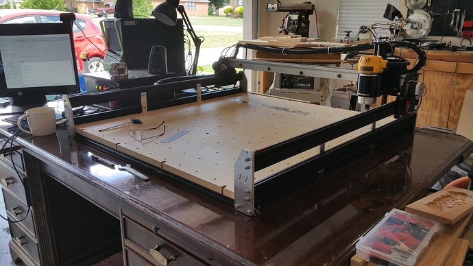

I began installing the new gantry. I had to use the V Wheels form the old gantry on the new.
It went together fairly well. To fit the current Y rail spacing I had to mount the V wheels right against the plate, just like they are for the standard gantry. So the eccentric spacers are on the outside, just like the eccentric nuts are.
This is how I mounted it:
Bolt ->Spacer->Plate->Washer->Wheel->Locknut
Though I suppose reversing the bolt would have worked as well:
Locknut ->Spacer->Plate->Washer->Wheel->Bolt
This means that I did not need to countersink those holes. In fact the counter sink is a problem as I had to grind down a wrench to be thin enough to slip under the bolt head and adjust the spacers.
I could have put the spacers on the inside of the plate, which I suspect is better for supporting the wheel, but that would involve repositioning the Y rails and trimming the waste board. A lot of work, so unless it becomes a problem I will wait to do that until I redo the y rails.
So far I got 2 upper wheels mounted on one side and 2 sets of upper and lower wheels mounted on the other. It rolls nice and smooth. And the gantry is exceptionally solid. A definite improvement over the maker-rail.
It will take me a couple more evenings to compete the changeover. I should be ready to run some test cuts this weekend. :grinning:
In retrospect I wish I had ordered up new V wheels as well. I would have cost more but I could have test fit and mounted the new gantry without disabling the machine. But I think these plates will work good enough that I can get the machine running even if I find a flaw that requires me to cut a updated set of plates.

Progress Pics:
There is the upgraded belt and pulley as well as 8 V wheels (4 upper, 4 lower). They all lined up no problem. The wheels just clear the tie wraps on the belt. They used to hit before. But I got extra thin tie wraps and adjusted how I lined them up to get this to happen.
The edge of the wheel just barely sticks out past the bracket. I will update the bracket design so that it sticks out instead to better protect the wheel
Here is the outside. With this setup the wheel holes donā€™t need to be countersunk. So I will be removing it from the design.
The limit switch holes are too far back from the edge to directly mount the switch. I need to move the holes closer on the design.
Here you can see the X and Z axis. That is a LOT of wheels!
It is pretty stable. There is still a tiny bit of flex, but that is the c-beam twisting, not the mounts.
Because the whole rail moves up and down, not just the router mount, I will need to figure a new way to set up the limit switch. (Maybe have it trigger on the lock bolt of the bottom wheel?)
I was able to reuse the original router mount but it is only held in place with 2 screws.
I have new 2 new router clamps on order to replace it.
The gantry bracket takes up more space under the gantry rail, but the Y brackets are taller so I have the same amount of usable Z height. I plan on making new Y rail brackets as well to increase the Z axis height. Once I know what Y rail setup I am going to use.

Updates on the build:
I did a test cut last night and my mm per revolutions were way off for the Y axis with the new belts, so everything came out elongated.
I got it roughly dialed in. Accurate to about .5mm per 100mm. I will do a more refined calibration once I get the new router mount setup
Also while the gantry rides higher, the bottom of the Z axis sits a lot lower. Reducing my z height a lot more than I expected. Giving me about 75mm of clearance. With bit height and my extra MDF sacrifice sheet it worked out to less than 20mm of cut depth. As it was I had to raise the spindle mount up to get enough clearance for my 1/4" bit. So new end plates are a must.
I considered redoing the Y plates so the gantry rides higher. But I think it may better for the gantry to be closer to the Y rail for stability? I think it will be easier to stabilize taller end brackets instead.
One of the upper fixed V wheels is slightly out of alignment so it doesnā€™t make good contact with the rail. I am not too worried about it as the other 7 are fine. I need to re-check to make sure the hole is properly laid out in my design.
The original v wheel bolts are just a tiny bit too short on my bracket when used with the eccentric spacers. I have longer ones on order.
I need to re-calibrate the Y motor currents for the new setup as well the acceleration jerk settings. After that cut new end brackets and redo the waste board.
