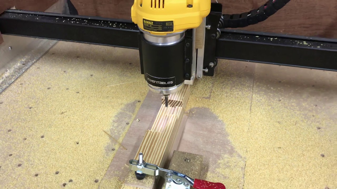

Got around to implementing this. Here is a video and picture of final result. alignment still requires some tweaking.

On the curved end there is a slight difference in height. This is partly because I told the software that the workpiece was 44mm and it is actually 43.91. But more likely I need to have some force onto the workpiece in the -X direction to force it against the bump stop.
I will also use some aluminium foil to get the exact X position of the piece.
I will post again once these steps have been executed to show how accurate I can make it.
Any suggestions to help the accuracy would be most welcome.
Tweaks:
Set width of piece to 43.91mm and altered design accordingly.
Found actual x center of piece by clamping aluminium either side of piece, used touch probe on each side and calculated actual x coordinate of left side.
Ran the job and compared results.

Job took
I couldn’t be more pleased with the result. Perfect alignment.
Tweaks worked!
