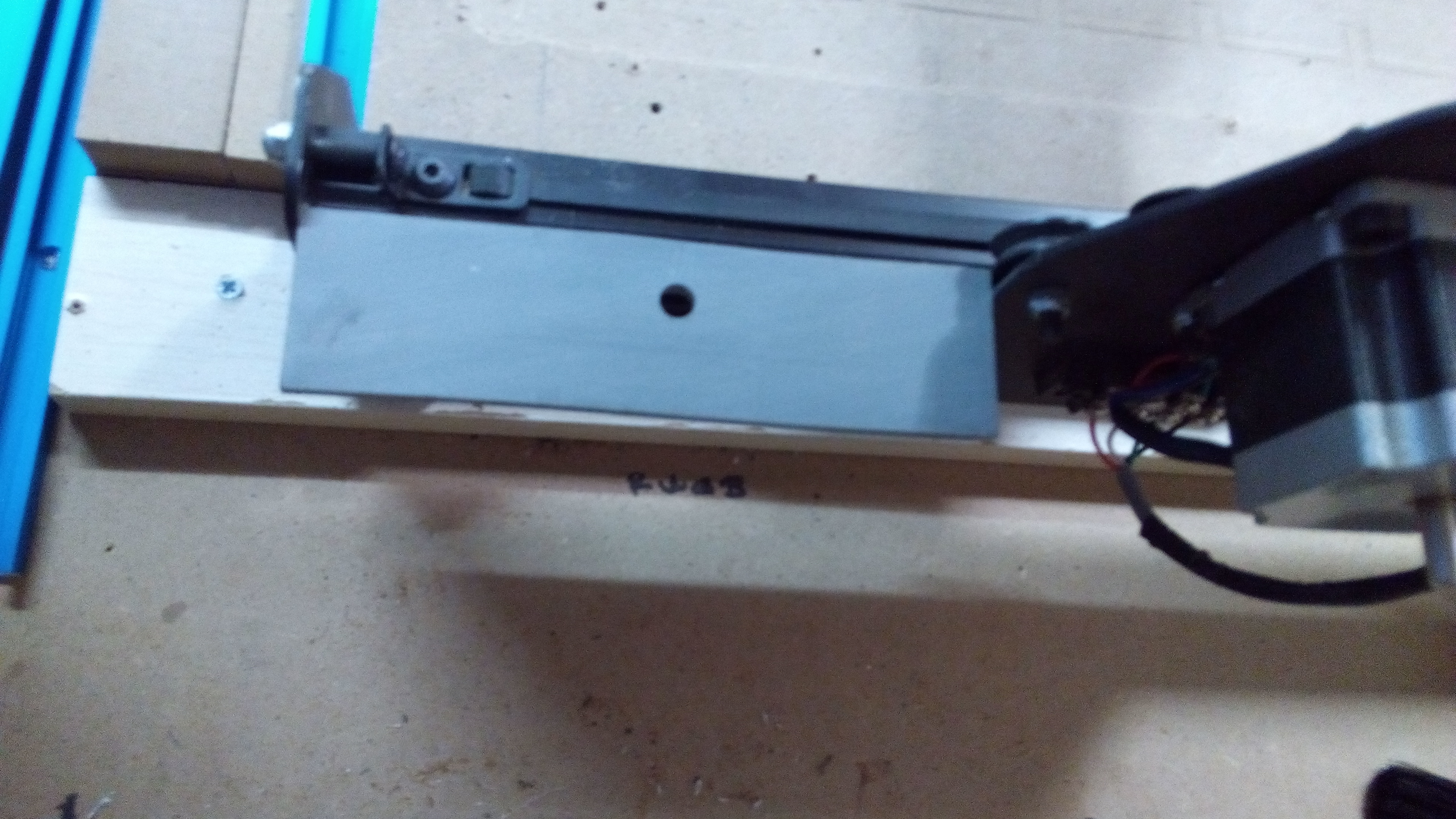

How do you keep your X-axis perpendicular to your Y-Axis? When I manually the move the X-axis, I can move one side 1/4-1/8" without moving the other side, which leads to the X-axis not being at 90 degrees with the Y-axis.
I discovered this while cutting a 24" square. The left/right sides were perfectly square with the machine, but the front/back were skewed (one side was 3/16" lower than the other).
Do I just need to manually square the x-axis before turning the machine on? My friend suggested I put stop blocks on the back of both y-axis rails and adjust them so that I can push the x-axis against them to get it perpendicular before turning the machine on.
I use two equal size of Plexiglas pieces, stick them to edge as shown on the picture. Turning machine on while pulling axis. Steppers locks, your X axis is square. Doing this every time after turning machine off.
Thanks Alan, simple and effective :slight_smile:
I ended up doing something similar with two pieces of plywood and only had 0.01" error over a 24" span. Getting my machine perfectly square would probably get me closer to even less error.
