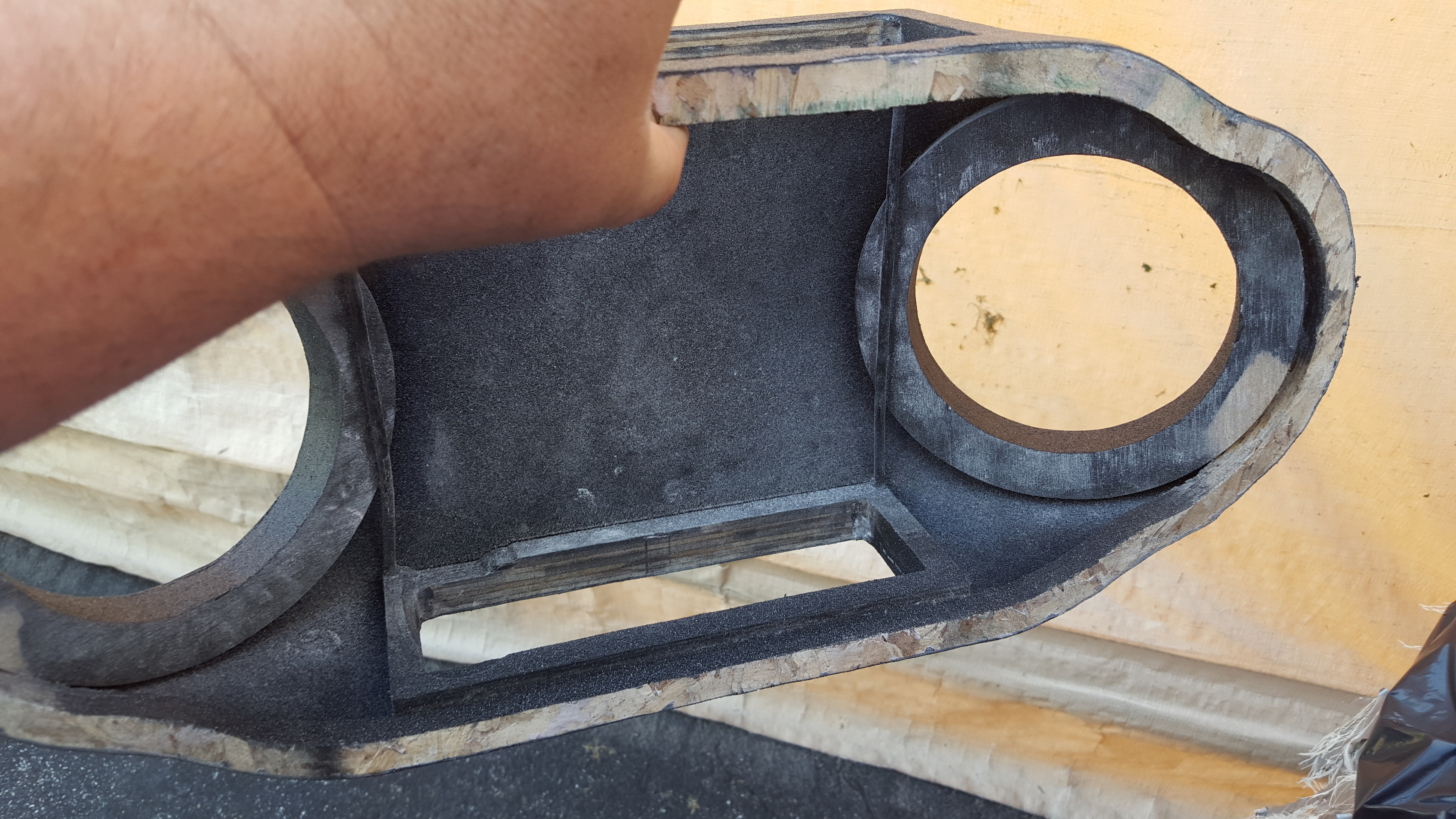

Made this radio pod for the golf cart. I used the xcarve to cut out the speaker rings, radio mount and sub frame then wrapped with felt and coated with fibreglass resin X2 then sanded and painted with stone textured paint. It is upside down in the photos it will mount to the inside of the roof with a trim ring i am still working on.
So here it is today all wired up and ready to rock.

This… is freaking beautiful.
Thank you. I will post another pick after it is installed in a few days. Sometime soon I will be making another and am thinking of making a vid of the process.
